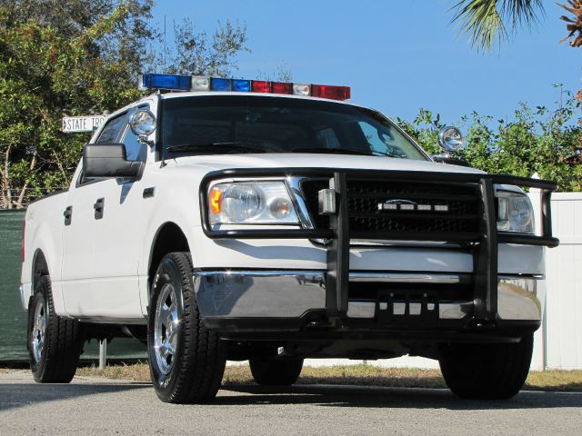

I am planning to buy a 2" leveling kit for my 2007 F150 S-Crew, but I wasn't sure if I should buy them from a vendor here or look on ebay. After that, I may buy an Add-A-Leaf (I think that's the name) for a 1" rise in the back. I have LT265/70R17 General Grabber AT2 tires on Expedition wheels, so I don't want to lift it too much or the tires will look small. I need to line the bed and get a tonne cover.
Here is a picture of the truck as it appeared when I bought it -
It belonged to the Cascade County (Montana) Sheriff's Department. I removed the overhead lights, LED grill lights, antennae from the roof, and the laptop. The above shot also shows the old tires/wheels. I plan to keep the prisoner partition, working video cameras, and shotgun/AR mounts.
