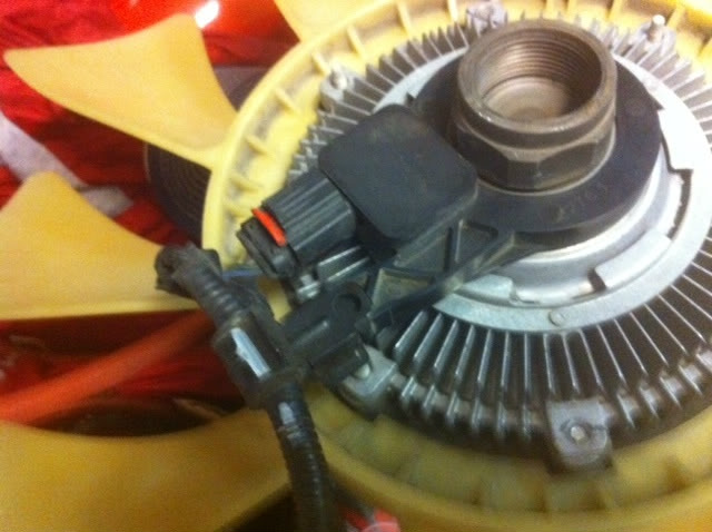

Well possible issue. I'm throughing codes 480 & 528, both dealing with fan speed or fan circuit voltage. Its something to do with the electric module attached to the fan being not plugged in.
Anyone else have that issue? I e-mailed Troyer to see if he can delete them in my tune.
Strange thing is they didn't show up until a reprogram today to my winter tune. About ten DTC's showed up after tune, but only the two + 1000 stayed after clearing DTC's out.
Here is a pic of what was attached to the fan clutch. I hope Troyer can make tunes not display these. Truck seems to drive without CE light, but I was thinking after x #'s codes it came on?

Drive it ! My 07 has had that code ever since I unhooked the fan and put the e-fans on. The PCM thinks the fan isn't working (it isn't), but it never trips the cel at any time, and no difference the way it runs, so as far as that code goes, just ignore it unless it does set the CEL on, then, I don't know

What about all the DTC's after reprog that i had to clear? 10 in all. Everthing from rev limited to forced engine shut down.
Maybe it just through every system check after fan as an error since it failed fan check?
Truck is running fine after clearing with only DTC's 1000, 528, & 480 remaining. 1000 should go away in a few days.

You should be ok 's-r', can't tell why you had all of those codes come up, but, ya I have the same codes all the time without any CEL light. I don't know if that can be 'programmed' out or not. maybe there is a resistor or something that could be used to get rid of the code, don't have a clue though, other that I know it doesn't hamper the truck at all.
