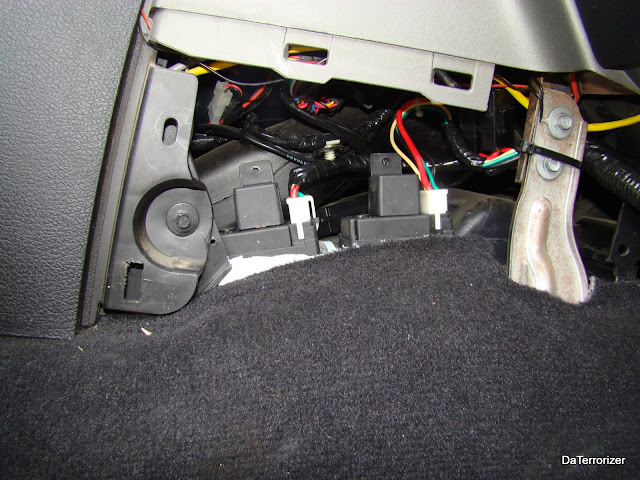

Oh yes the thought of course has crossed my mind, but the second time they were installed the tech was on the phone with Mr. Troyer's staff going step by step to ensure proper installation. Mr. Troyer said that all of the damaged controllers were broken at the circuit board, possibly from jiggling it back and forth when I/we removed the relay switches. Mr. Troyer insisted that the relay switches not be removed because it will damage the circuit board.
I understand his instructions, but in all 3 cases, here I am just your regular John doe, truck overheats, I notice the fans are not working, I trace every wire to make sure none were loose and finding out that the relay switches were melted. Ding, what comes to mind, no problem I'll just hot wire it so I can make it down the hill and purchase a pair of relay switches at the nearest Pep Boys. But Mr. Troyer insists not to attempt to remove the relay switches, but to remove the controller all together and send it back undisturbed.

I finally picked up my truck yesterday evening with the 2 new controllers installed now inside the cab. I also asked for the auxiliary switches to be re-connected in the event the controllers fail again. So far I've driven the truck about 50 freeway/expressway miles, so far so good. Tomorrow I'll take it trail riding in the same area you see on the video down bellow.
