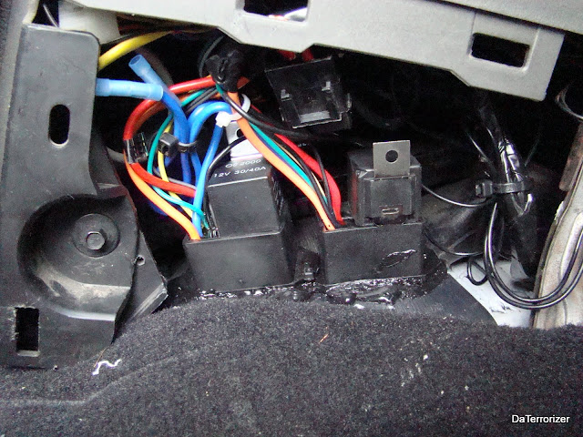

Yes I'm using the same installer who talked to Troyer and his assistances, same installer who asked questions and was guided step by step to install the controllers as per Troyers instructions. Yes I will definitely update you all on the new set of "cheap" controllers. They go out in the same time and manner Troyer's controls did, I will then have to have a "serious" talk to my installer.
Here are the new controllers:
