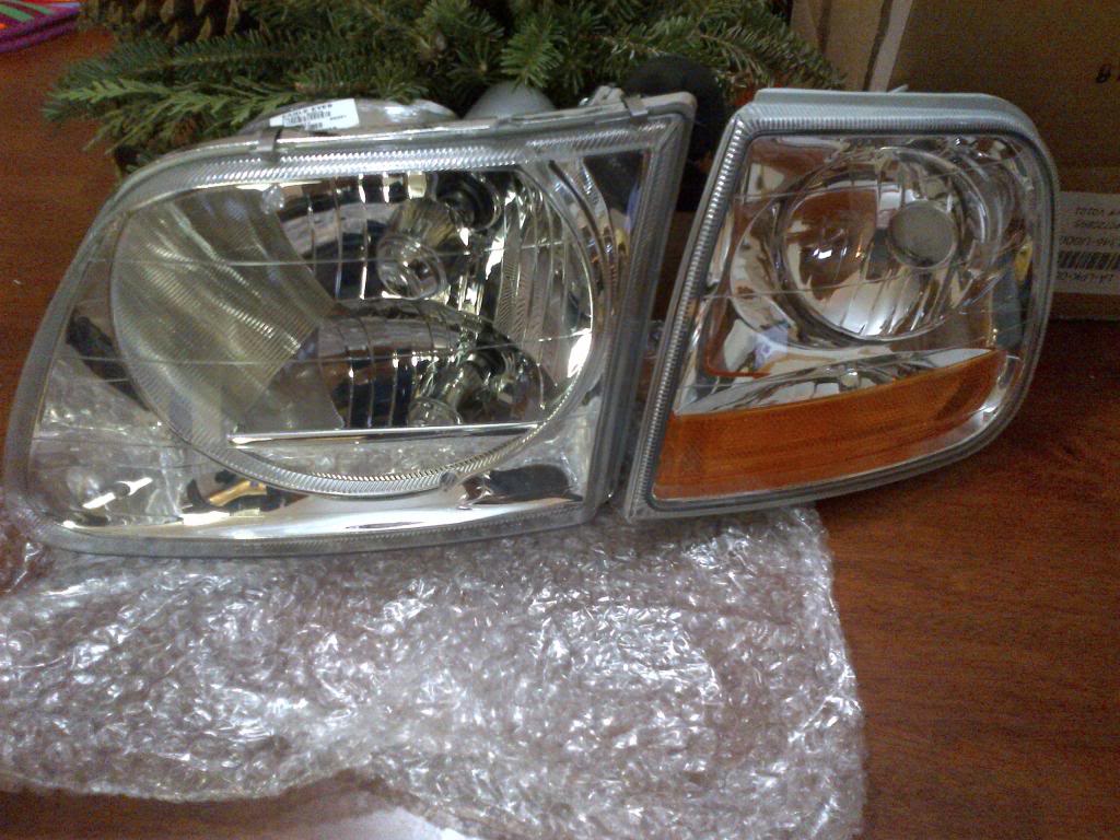

My headlights are here. I'm getting excited now. I think I will go with the 50 watt 5000K in the FX-R Stage 3 in 2.5 lens and with the Apollo V2.0 shroud. I will also go with the Amber XB LED angel eye in the shrouds. What do you think? I hope to get the TRS kit soon! Name:  IMG-20130104-00589_zps6592297d.jpg
  #119
Old 01-05-2013, 09:09 PM
Raptor05121's Avatar
Join Date: Jan 2007
Location: Live Oak, FL
Posts: 10,610
Received 6 Likes on 4 Posts
that sounds like a winner

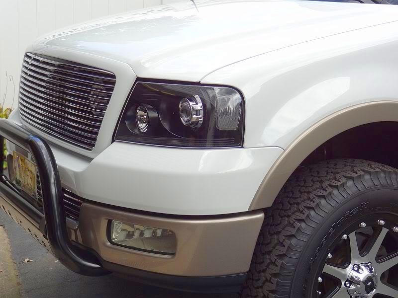

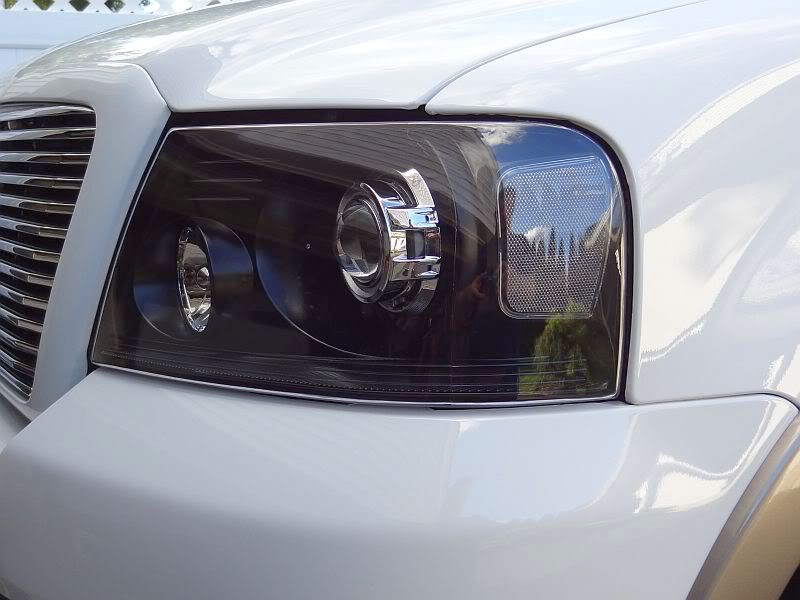

PM'd you pics of my 04 Lariat retrofit to be included..
Thanks.
