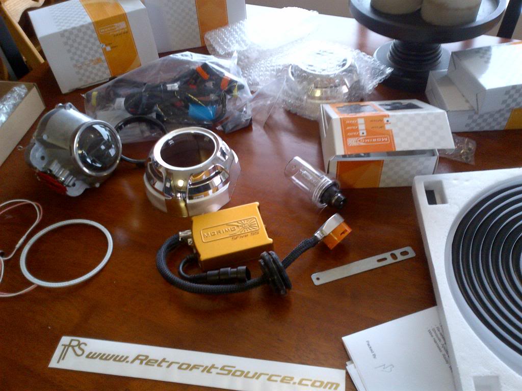

Just came in. Looks like I will get to start soon! Name:  IMG-20130124-00624_zps15573787.jpg

Let the fun begin!!!

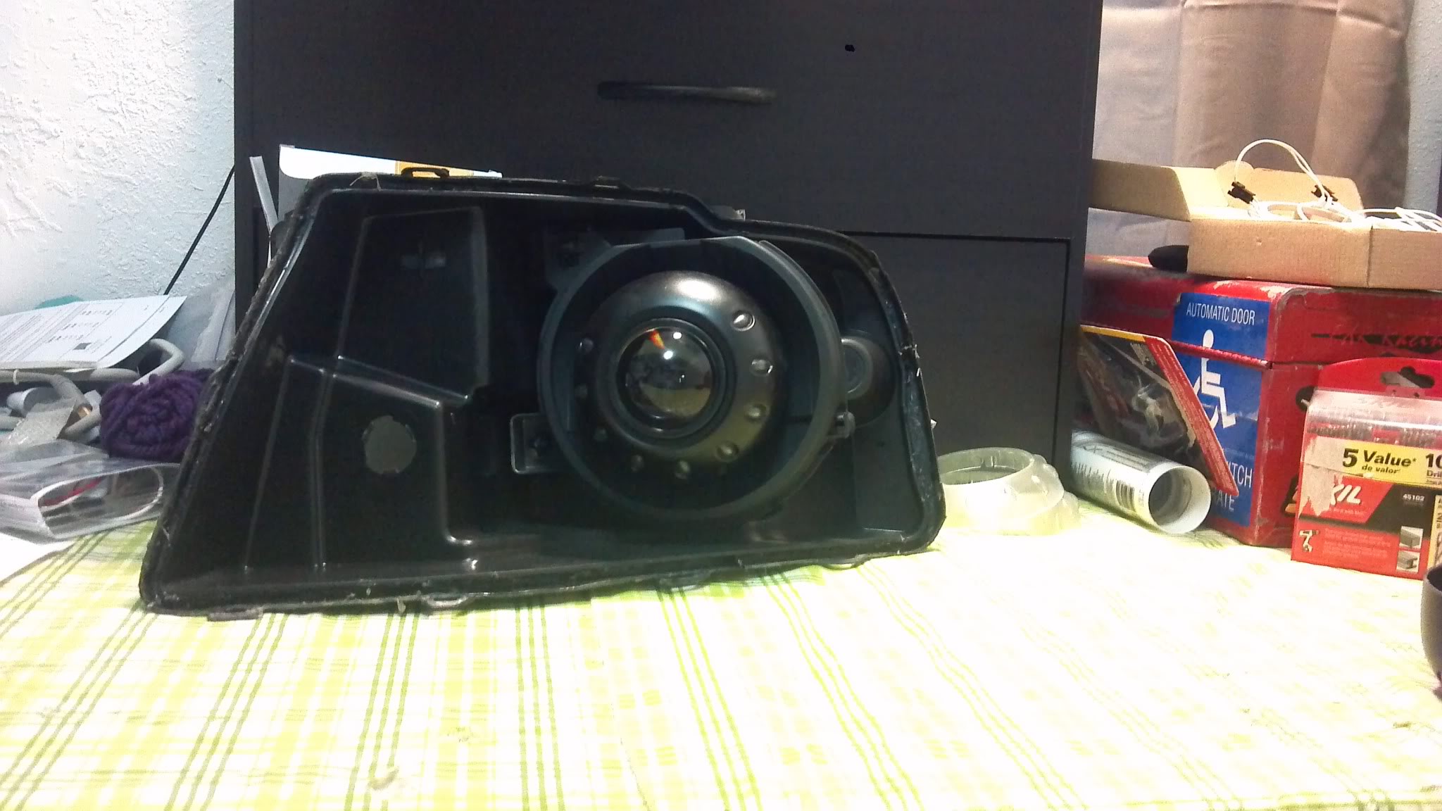

Hello all! new to the forum but i have a retro as well. I got the truck a month ago and it was the first thing i did lol. I used lightning housings and Mini H1 4.1 projectors. GG shrouds and Morimoto XB35 5000k bulbs powered by 3five ballasts and MotoControl 9007 harness.
I used the GG shrouds because they came with the projectors but i will be switching out for some e46-r shrouds to fill up some of the void. I might paint the inside of the corners and headlights.
Here's some pics!

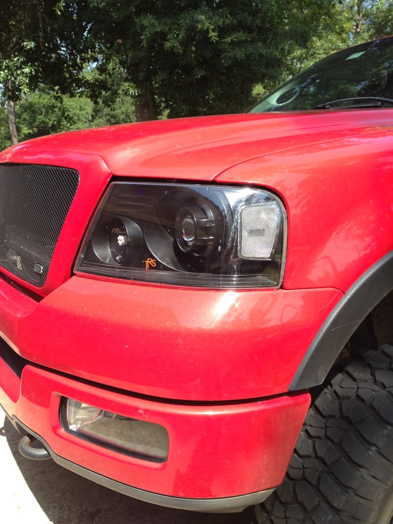

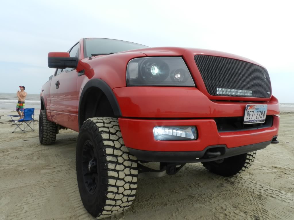

Another one to be added here:

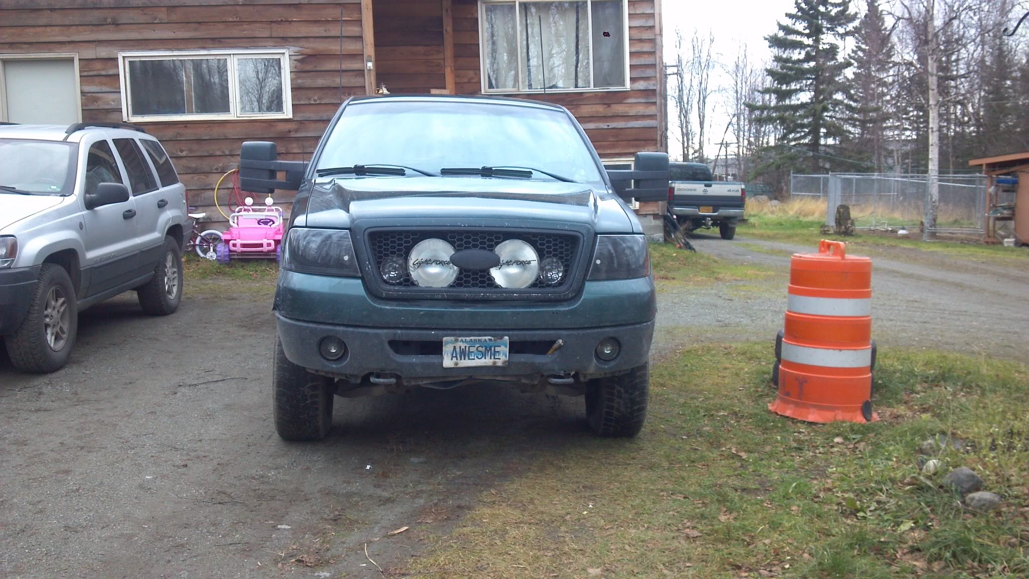

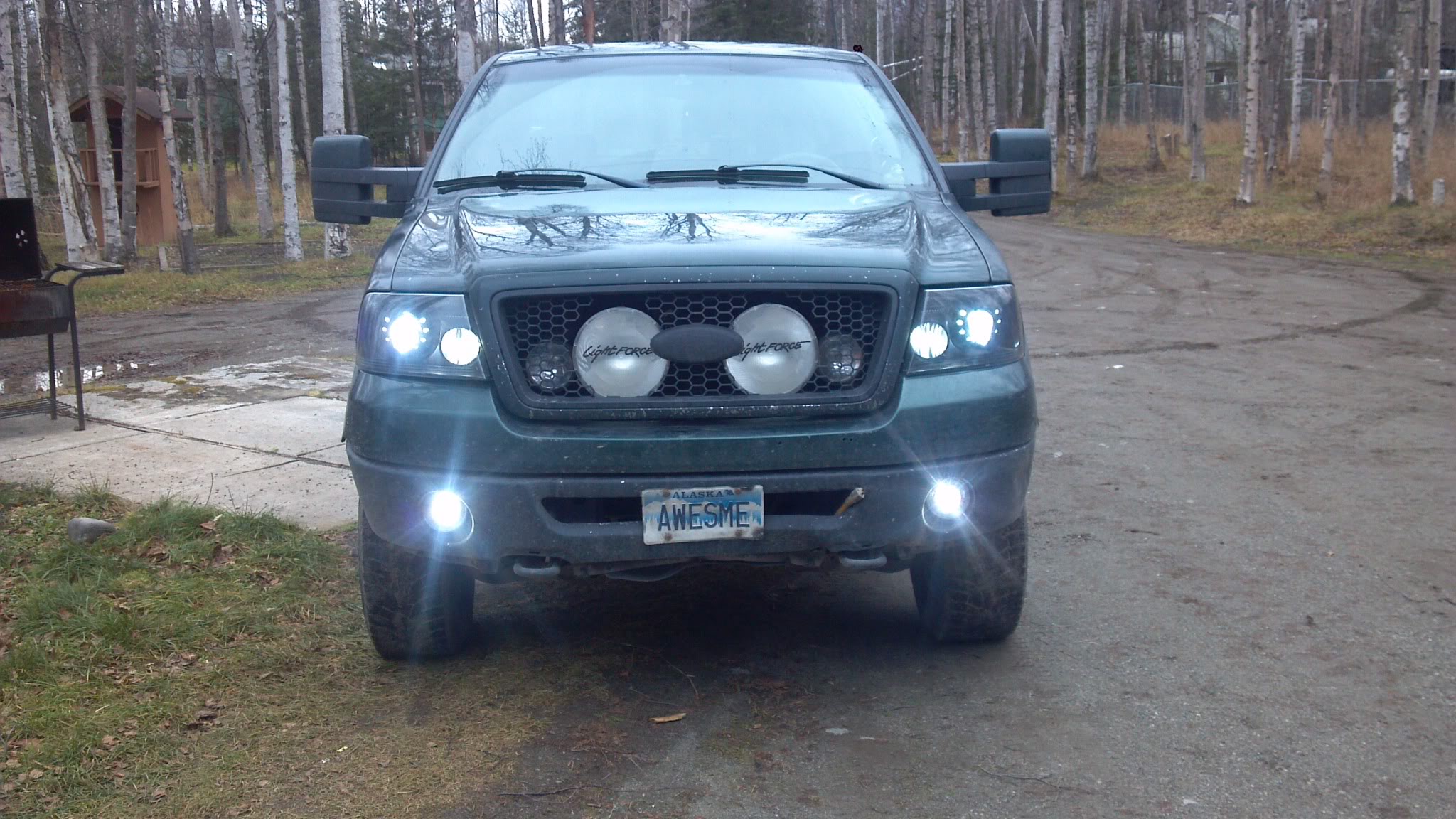

Add me up too.
2007 F150
Matchbox Projectors in fogs. 6000k
Mini H1 stage III Projectors with MC-R shrouds and CCFL Halos in heads.
