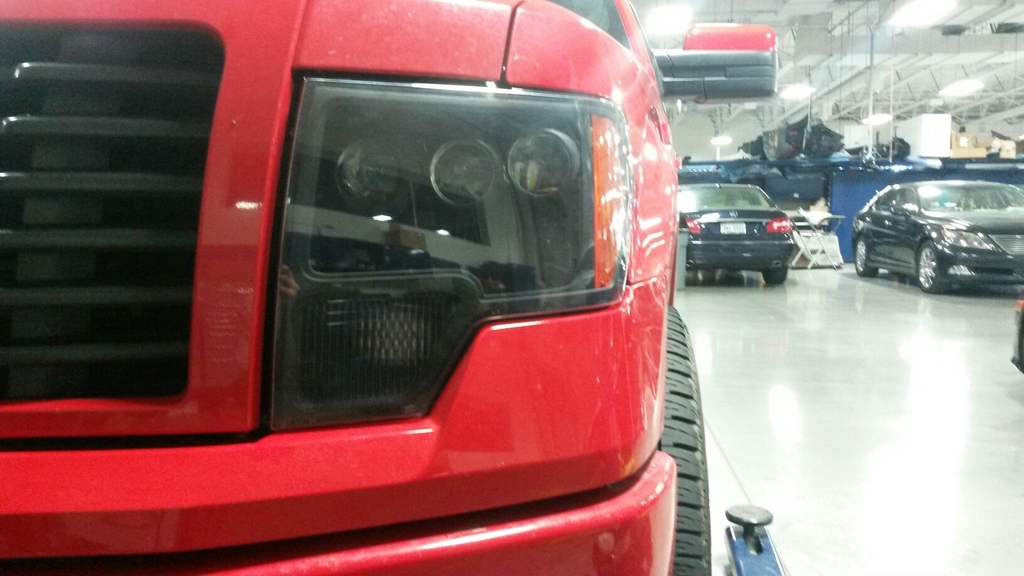

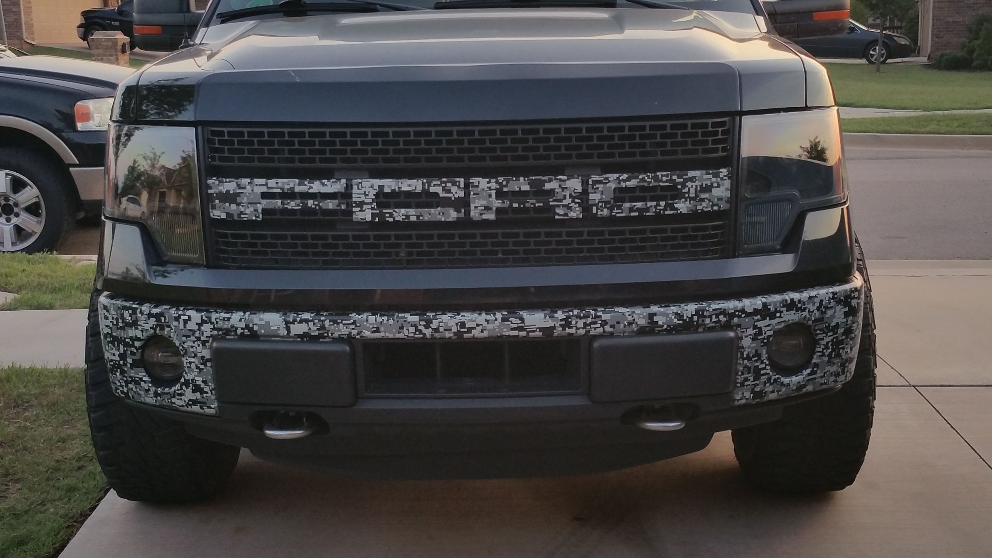

The ones I have built
Just a little sample of what I've done...
