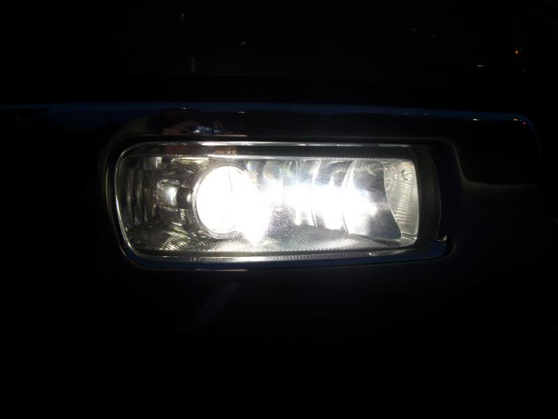

Raptor, here is a picture of my fog Retro:

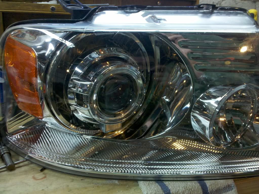

Same pic with new address. Sorry for the lost link

I want to see some black housings with the FX-R style projectors that do NOT have the entire headlamp bowl painted. I really dislike that look. Anyone have it done?
Similar to this even though the bowl is painted. The fat projector still helps with appearance looking attractive.
