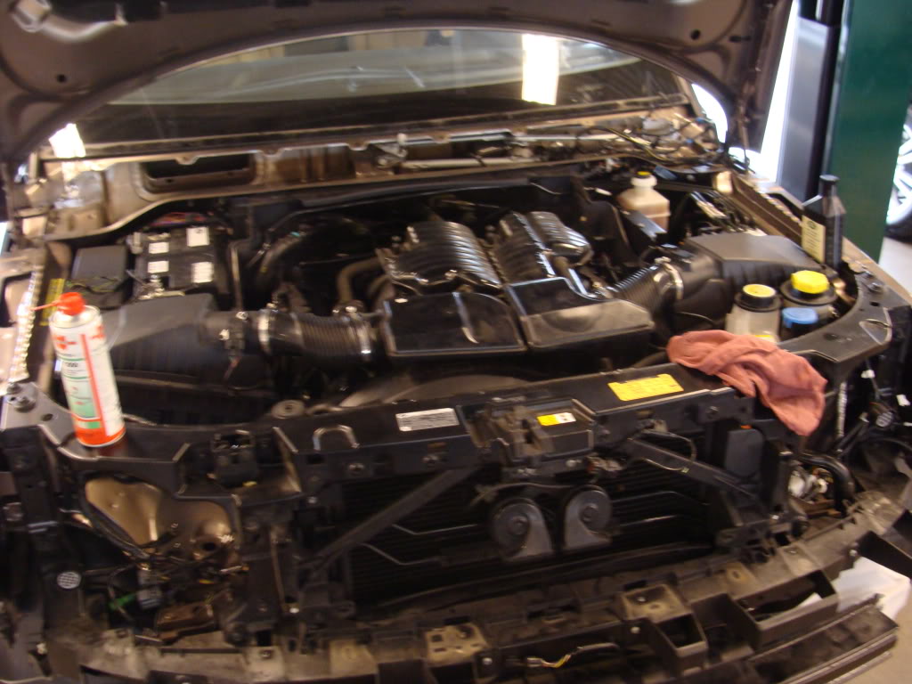

Here's today progress:
True crate engine
Swapping over front accessories, headers and engine mount brackets
Interesting the exhaust manifold gasket is also the heat shield mounts
And going back in with it

Why didnt you just swap a Viper engine in there?
Old Sep 24, 2010 | 09:05 PM
  #39
Starting to look like an engine bay again
Land Rover approved engine lifting bar, and old engine getting boxed back up
Got everything finished under the car, just need to put the bumpers and lights back on
Tada!!
And as a treat, I shot a video of it this morning with open exhaust manifolds. 5.0L hear me rawrrrr
