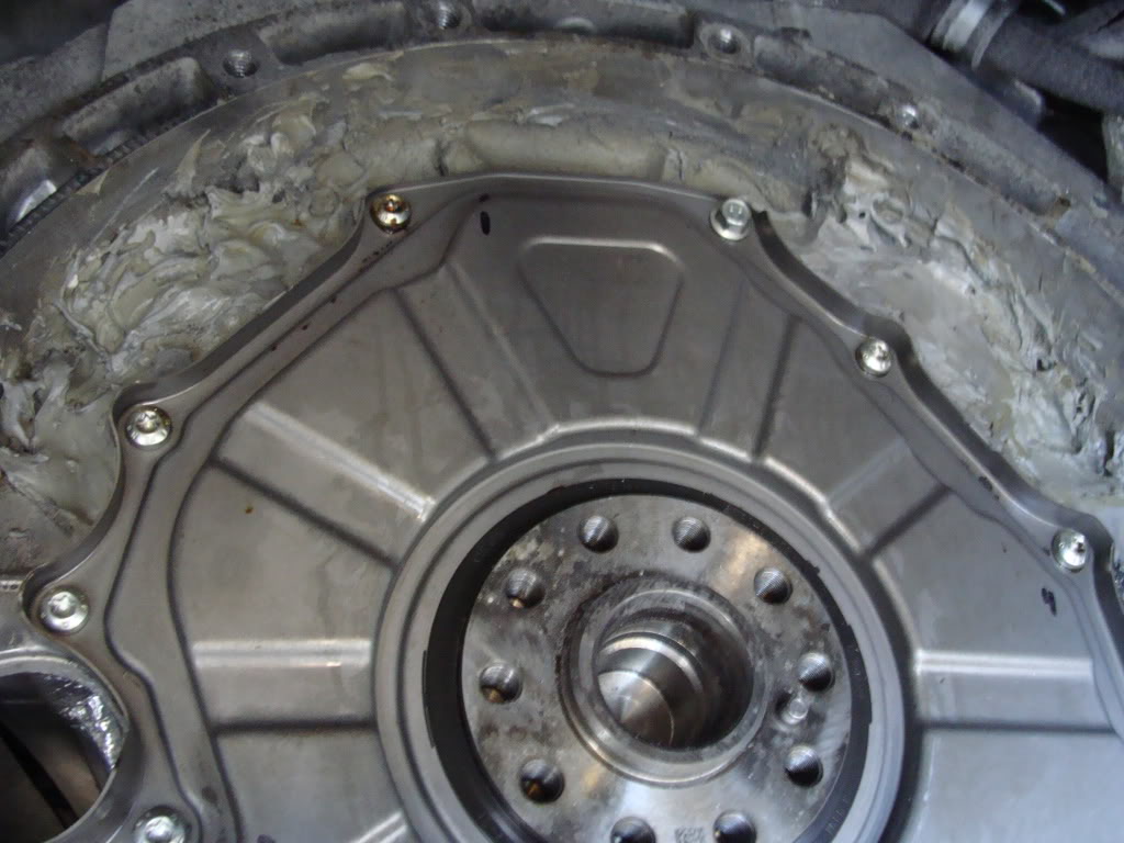

We have tried to "repair" this engine three times by adding Devcon F (aluminum putty) to the back of the block. There is a high pressure oil line that pushes oil through the porous aluminum block. They have a new block design that had better castings on the rear of the block to fix this concern, but they are trying to bandaid fix as many as possible.
Land Rover says you have to pull the body off the frame to perform the engine swap. I was on a quest to find a way to squeeze it out the front.
Pics:

First step is removing transmission to verify the leak. 3 hours work. Drop the exhaust, both driveshafts, couple heat shields, harnesses clips and then there are the torque convertor bolts that go through the front of the flex plate into the torque convertor.
