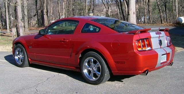

Love the color of your mustang btw tbear. It's funny, people crap all over the 3V mustangs as being "slow" Maybe I'm just an old fart at 29 y/o...but I find it plenty peppy. Went for a nice drive last night and just enjoy the hell out of the car.

tbear853's Avatar
Posts: 3,031
Likes: 45
From: The Shenandoah Valley
The weight is an interesting topic I have researched a bunch as well. It definitely can work in a lot of cases from everything I have read. The "issue" with my set-up is just the sheer loudness now. True exhaust drone really needs a Helmholtz resonator/J pipe or just a straight up muffler swap to solve the issue.
The long glasspack toned noise down, mellowed it, the weight took care of certain frequency droning.
When I built my house, I had a buddy comment on my nails, I laughed, told him I never use "just" two 16s where four will fit ... I also tend to double nut some things as a locking method. I didn't want two pipes with concrete sealed in them bouncing out from under my truck.
from 2016. The exhaust is WAY louder now. It's hard to believe how much louder it has gotten. It is seriously louder than the Roush exhausts on the 5.0 trucks (multiple family members own them so I know the loudness).
Age will do that to you too.
The 14" Borla Pro XS arrives today. Looking forward to installing it tonight.
I'll be checking for updates. If you find a drone, try just clamping some weight firmly to the pipe there under your cab ... just for kicks. Ford had a weight welded to my truck's OEM pipe, the ones on CVs are bolted on at junction behind cats at H-pipe, I don't recall weights on the Mustang.
Thank You Sir!
I don't think slow describes them, "they" just jealous because our 3valve sounds better than thier 5.0. I know the "bar" has changed some since the '60s, but an out the door car on street tires that'll run 13s is not slow. 29? I was 29 once ... in 1983 I think.
