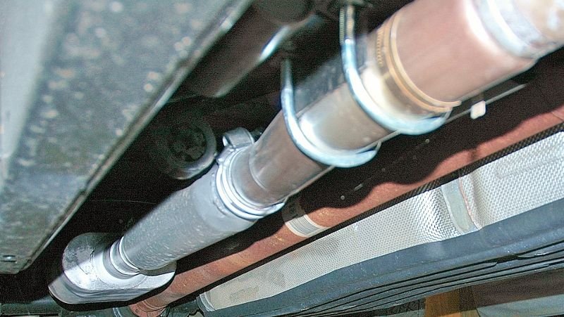

Wow, that was fast on the muffler R&R. Glad it worked for you. I didn't think about ordering the weights from Ford, did not even know they were still available. Mine came on a system I bought off a wrecked HPP Crown Vic to put duals on our Mercury, the Merc had weights already so I had left overs until I used two pieces of angle iron to make a cradle to weld the weights to ... made cradle to fit 3" pipe in my case, then I just clamped it as in the picture. On the CV each weight had a bracket so them mounted with bolts that hook H-pipe to the head pipes from the cats. I hope I didn't lead you astray. Here is another picture.

The ones I ordered appear to be attached via u bolts. For no no welder so must be bolt on, but you can see they likely will work just fine. I found reference to them be u bolt attached as well for forums.

Oh, I think U-bolts will work dandy with those, look like same weight, just different bracket. You could size the U bolts to the pipe and use two and mount the weights parallel beside the pipe. I think they will make you happy.

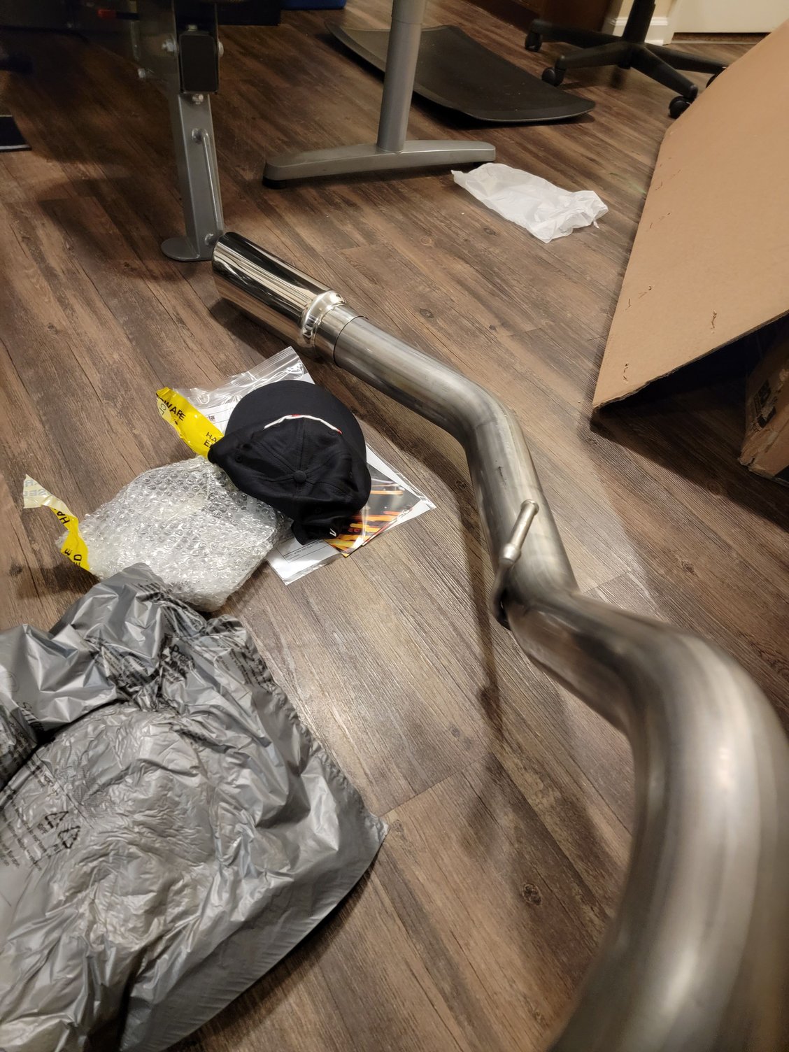

Well two years later and the Borla pro XS became too loud. I know I have gotten older over the past nearly 15 years of owning the truck, but these mufflers do get louder the more miles you put on them from my experience. Still in my early thirties and I love a good sounding exhaust, but I just can't deal with the drone.
After much deliberation, I finally decided to buy the Borla single and single out p/n 140136 cat back that they make for these trucks. Obviously incredibly high quality, and I did need to purchase some new exhaust hangers as I had removed mine years ago because I've had the side exit. Stupid me, so that involved a lot of parts catalog diving to ensure I had the correct hardware and retainer clips that you need to install those hangers. Not easy finding that stuff!
The goal is to eventually rework the angle of the tailpipe and install the Corsa style tip you see in the pictures. But I have to wait until I have my house because I can't use my welder in my living situation and I need some more practice with stainless. So I'm just rocking the standard 4-in Borla rolled edge tip for now. Bit of a bummer but it is what it is.
Even with my magnaflow high flow cats, there is zero drone and it is such a relief. The truck is definitely quieter, but it still is significantly louder than a stock 11th gen with this cat back. Has a real nice snarl going through the gears and then gets much subdued just like my Mustang with the GT500KR Shelby axle-backs.
I used all 304 stainless steel tubing to fill in the section of my intermediate pipe that is long gone. And once I am situated hopefully later this year, I'll start planning out making that section fully welded with only a couple of clamp in sections just to clean it up a bit but it is quite nice for right now. I'll have to get some sound clips in a few weeks as there's really not much online for the system.
