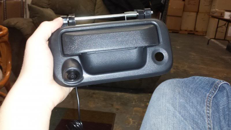

So it came in yesterday and I must say I am very very impressed.
Free two day shipping and the build quality and OEM look is great!
I hooked it up to my Edge CTS and the picture was phenomenal and will do everything that I need it to do. I'm just waiting for the snow and salt to get off the road before I install it so I don't have to dig around in the salt covered under body on my truck.
Here is a picture of it:

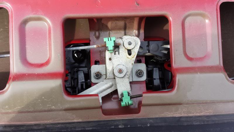

I partially installed the camera this weekend.
Here is the back of the tailgate with the access cover exposed ... all you need to do it remove those two nuts and the handle pops out

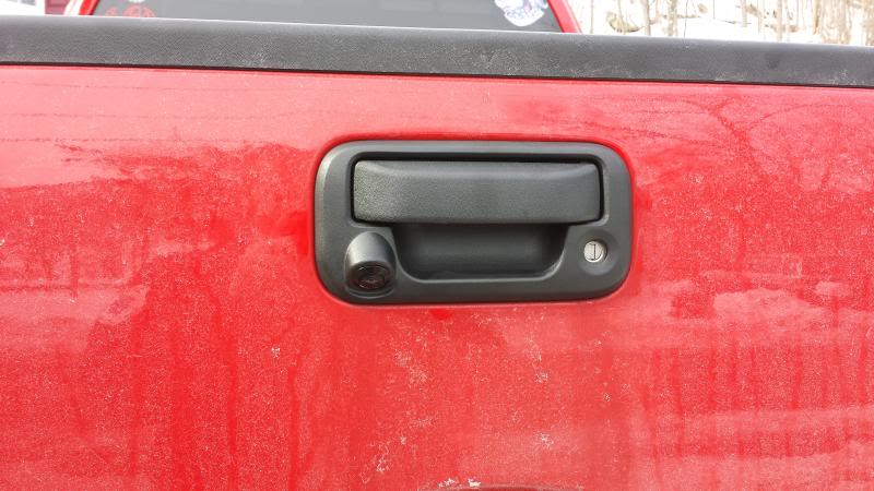

It came with a washer type thing but I did not install it because it did not line up, not to mention the stock one did not have that. Here it is installed ... looks great and fits great you would never know it was not OEM.

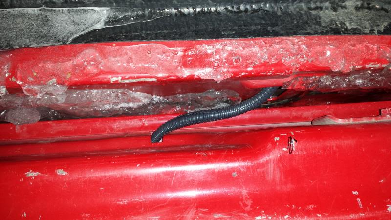

Now getting it through the tailgate and out the bottom hole was a bit of a challenge and I needed to take off the tailgate to do this step correctly. Not really a huge deal on such an easy tailgate to take off. I also decided to loom the whole wire because there might be some sharp edges especially at the entrance holes.
I went trough a small drain hole on the bottom that was near the only opening on the passenger side bottom of the bed.

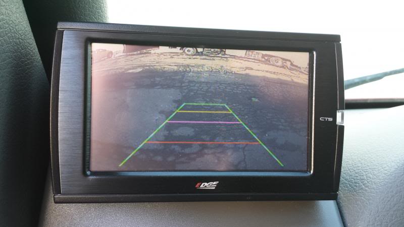

Okay so before anybody orders I just finished up installing the camera.
IT DOES NOT SHOW YOUR BUMPER OR A HITCH
I just called them up (and left a message) but I found an "adjustable" tailgate camera for $50 bucks more and they say that one shows the bumper. Pretty ridiculous that this one does not show it. Oh well it's still worth it for 150 ... Just hoping that they accept the return on this one so I can but the other one
Here is a picture of it working .... like I said it's a great quality image and great camera it's just angled wrong
