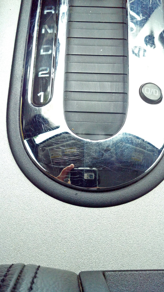

Any advice on how to remove some of the swirling and hazing on the interior chrome shifter assembly? I fear that trying M105/205 in a small amount with a micro fiber would possibly induce more marring and not fully remove swirls. Chromed plastic is just very unforgiving.

Treat it like paint. Get a good rubbing compound and buff it out with a microfiber towel. I would try the widely available plastics polish.. i.believe its meguires. I'll do a quick search and update

Meguiars PlastX. It should do the trick for those light scratches

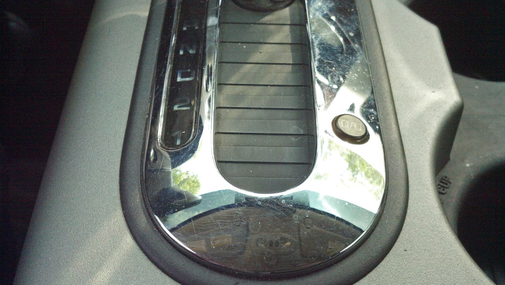

Well the Plast-X worked, made a noticeable difference. The haze, marring, and some spotting that wasn't removed before is gone. But the dings and scratches remain. If you can see the tapeline, the left was treated with plast-x twice. Right side untouched.

I tried using some scratch-x 2.0 I had laying in the detailing product pile but it didn't do anything. At least its cleaned up looking enough. If the next truck has one in better shape i'll just hit it with some collinite 845.
Old Aug 5, 2012 | 03:51 PM
are you sure that piece is plastic?
if its chromed metal you can be a little bit more aggressive with it...
I know on the STA its chromed pot metal.....

Try a paint rubbing compound, or mother's billet polish! Mother's billet it the best polish I've ever used

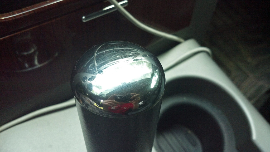

Hmm, no i'm pretty sure its some of China's finest plastic. The shifter top is, but this main shifter plate feels like plastic.
