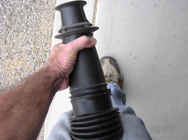

Old Jan 18, 2011 | 10:38 PM
  #60
giggity giggity giggity, and dang thats a tight grip you got
