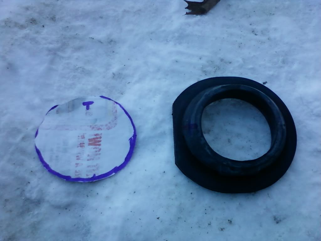

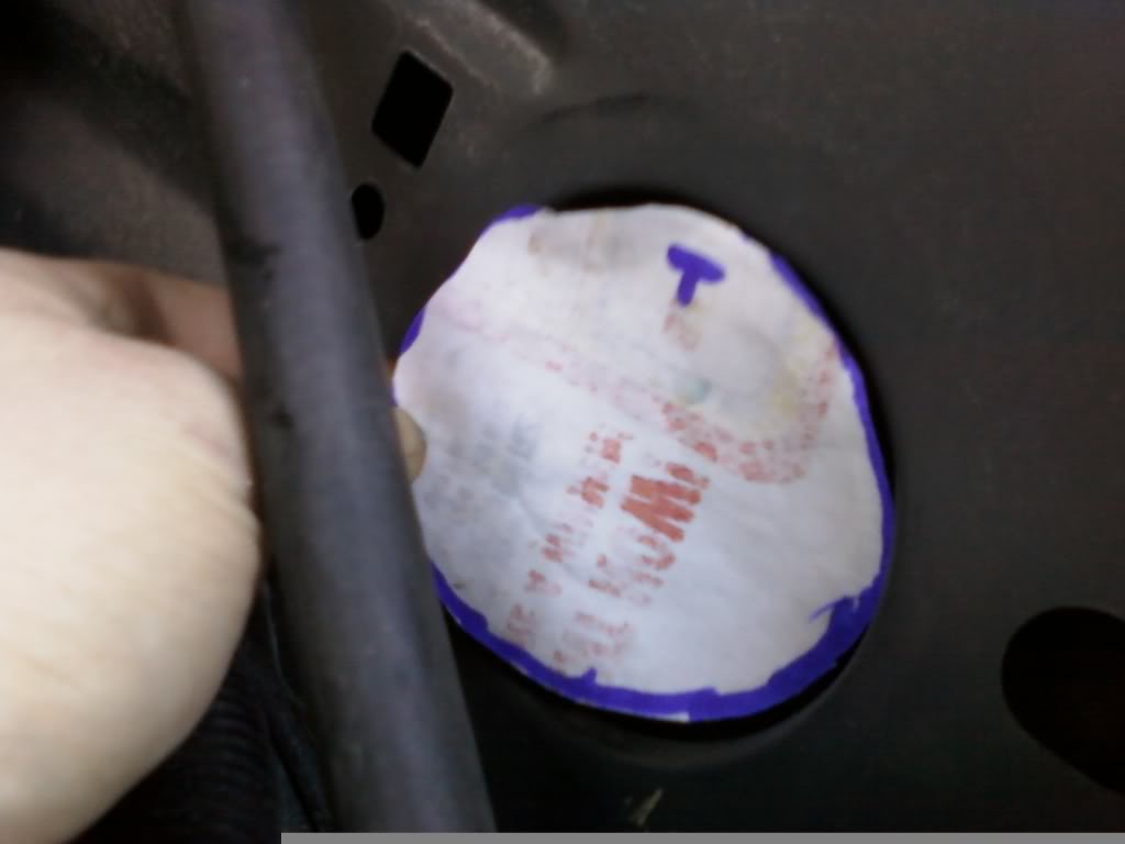

Here are a couple pics that I took when I did mine that may help everyone out with the grinding part.
I took a piece of paper and traced the hole in the fender and cut it out on the line
Then I compared the template to the rubber piece that goes into the fender to make sure it was close

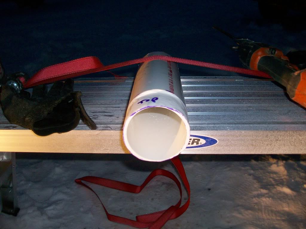

Next I traced the outline onto the end of the pvc pipe

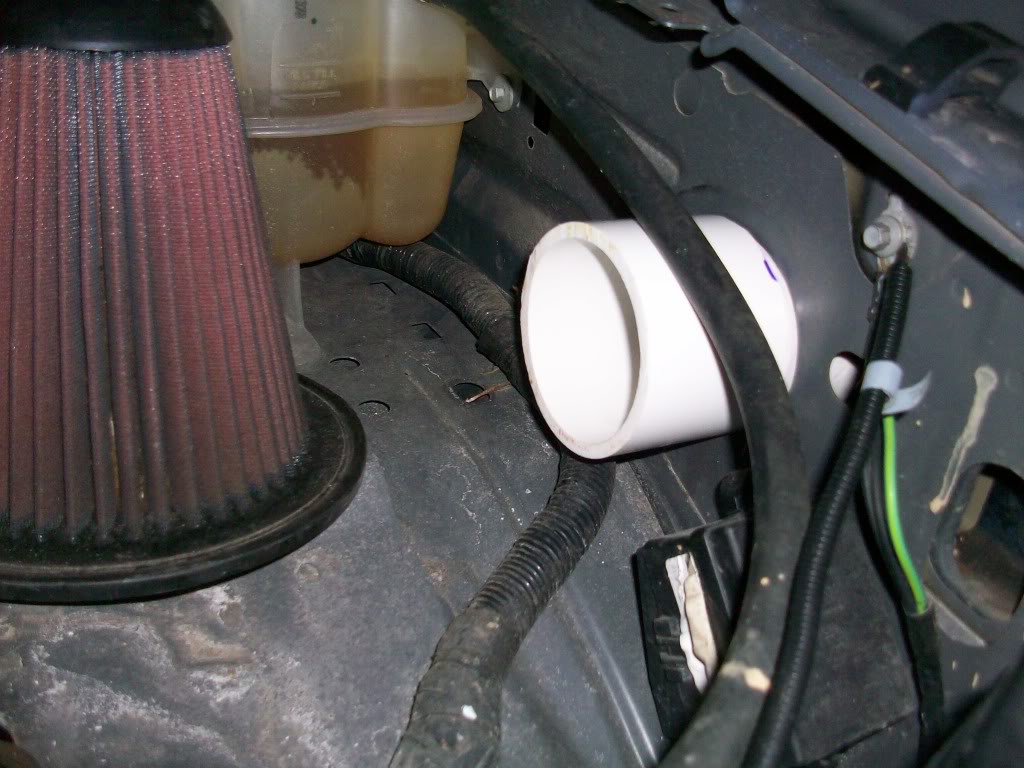

I used my Dewalt grinder to shape the pipe and found it easiest to use a ratchet strap to hold the pipe tight to a bench so I can just spin the pipe as needed. Just ground the pipe till my line was gone and tried it, fit the first time too
