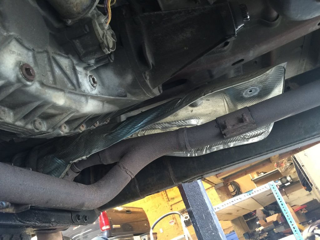

Jacked up
Rear driveshaft removed
Getting a heat shield removed in this picture
