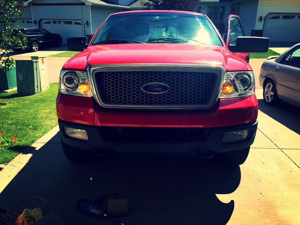

Installed switchback front turn signal bulbs today.
White LED when lights are on
Amber when turn signals are on

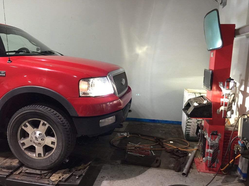

Wheel alignment completed. Steering wheel is straight now. Used to be at an angle.

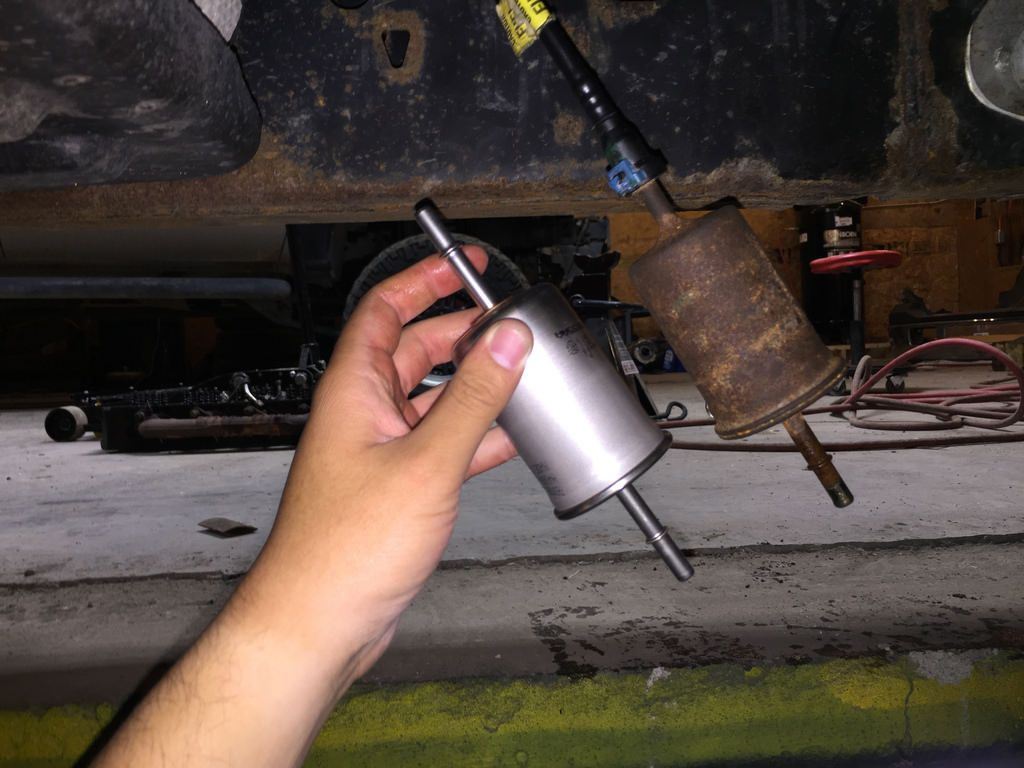

Replaced fuel filter.

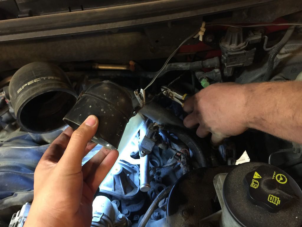

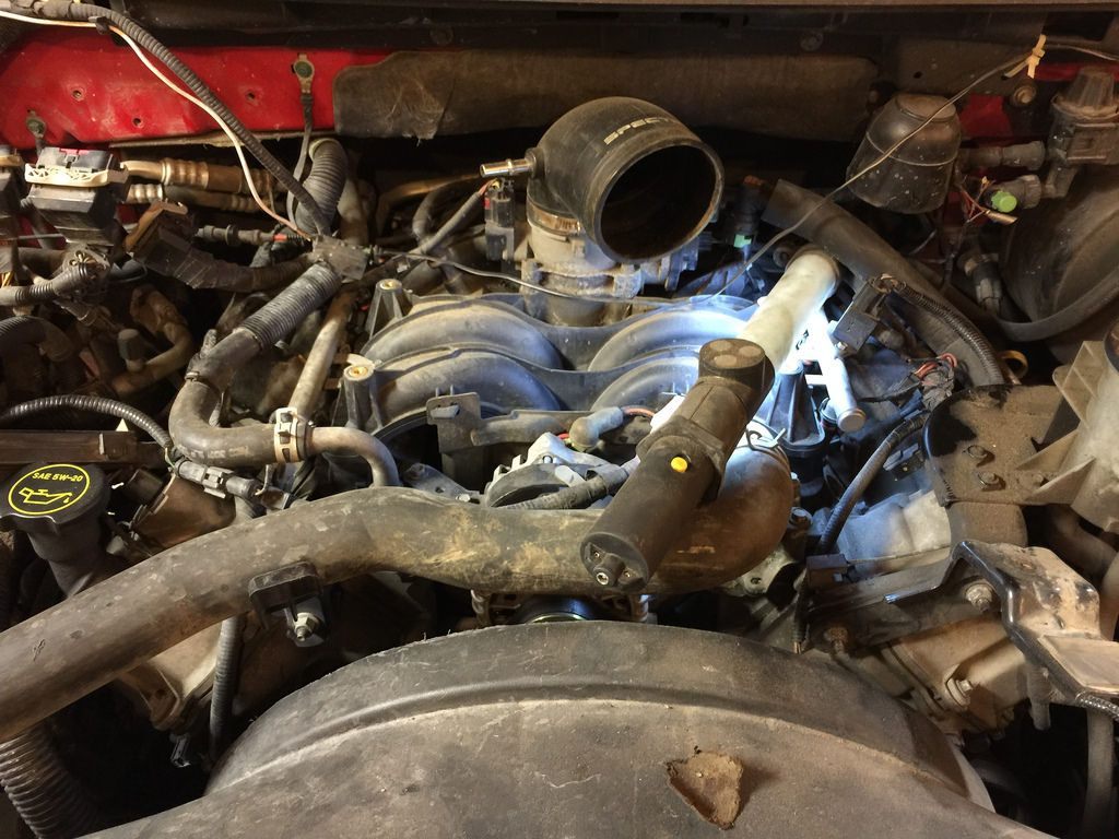

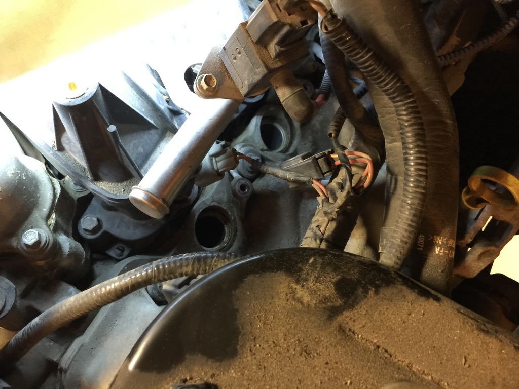

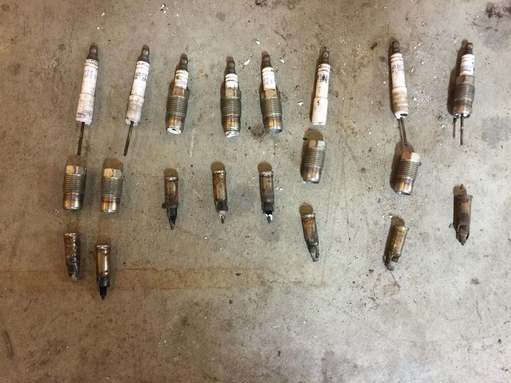

Originally purchased Denso 5326 spark plugs. These are the short design and they are not compatible with this motor. The threads do not fit.
Ended up purchasing Motorcraft SP-515's from the local dealership.
Took off intake
All spark plugs removed
All in all, spark plugs took an additional 5 hours to install due to the fact that all 8 spark plugs broke. Removal procedure as outlined in TSB 06-15-2 (http://www.rockauto.com/info/54PlugRemovaltsb208.pdf)
The truck now misfires and dies during idle. Will check it out tomorrow.
Took off intake
I did a plug change on mine about 6 months ago, all 8 plugs broke, and they looked EXACTLY like yours. Your sparkplug tips had the same issues as mine(electrodes burnt off/bent) and porcelain cracked off. I also was MISSING an electrode on one plug, I think it fell into the cylinder head. You look like your missing one as well.
I did my best to blow out the cylinders with compressed air, but I was really worried about debris in the cylinder heads/chamber. I played it REALLY safe and had the truck towed to the dealer where I had them bore scope every cylinder. They found large/small chunks of debris in the cylinders and were able to clean them out with compressed air and verified it was clean with a bore scope. They then oiled the engine from the top to coat the cylinders and slowly cranked the engine by hand to check for binding. $600 later I got the truck back, and runs like a beast....
I hope you didn't get debris in there and damage the cylinders.............

Nice job so far. I haven't seen a fuel filter that looked that bad before.
