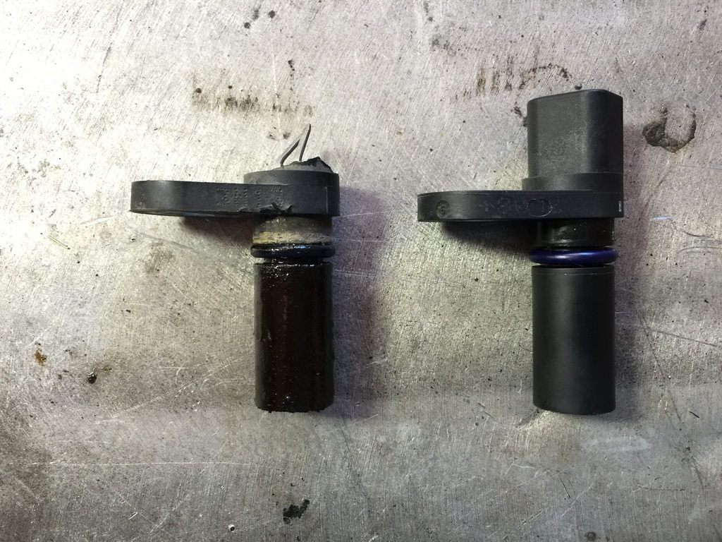

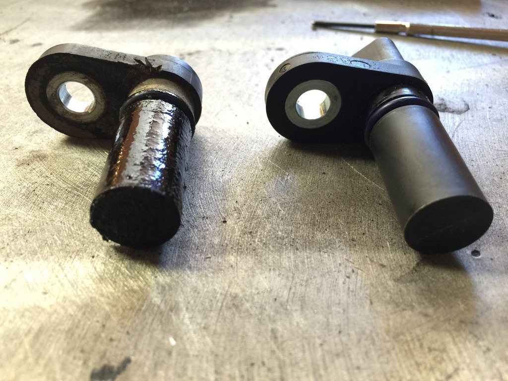

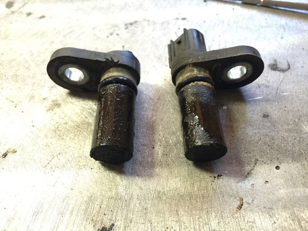

Check engine light repair.
Cam sensors were both damaged on both ends. The connector on the sensor broke off. The wiring harness is cut. Not sure why.
Replaced them today.
Damaged sensors side by side (Left sensor had the connector broken inside).
New sensor side by side

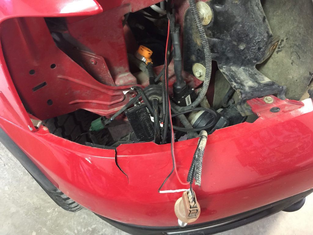

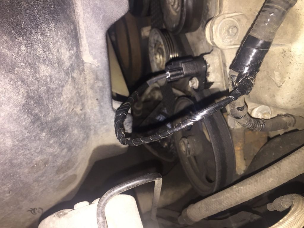

Added new wiring harness for the cam sensors (Previous ones were cut off).

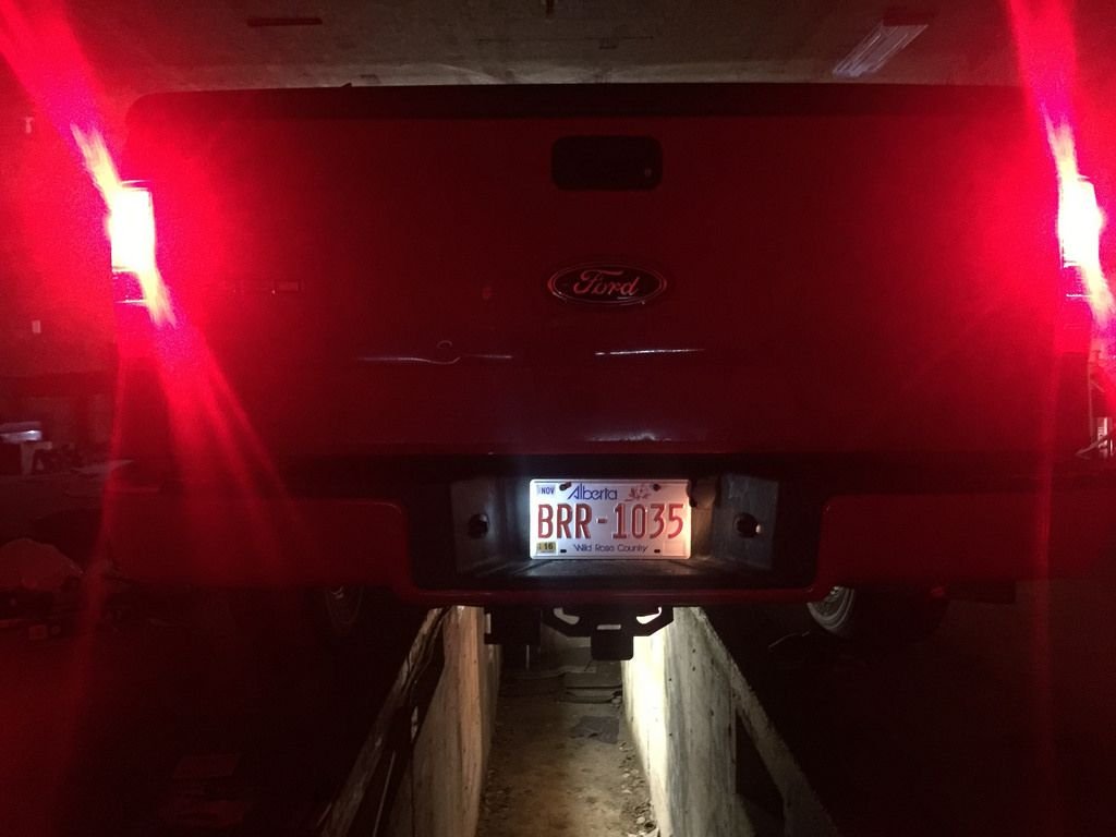

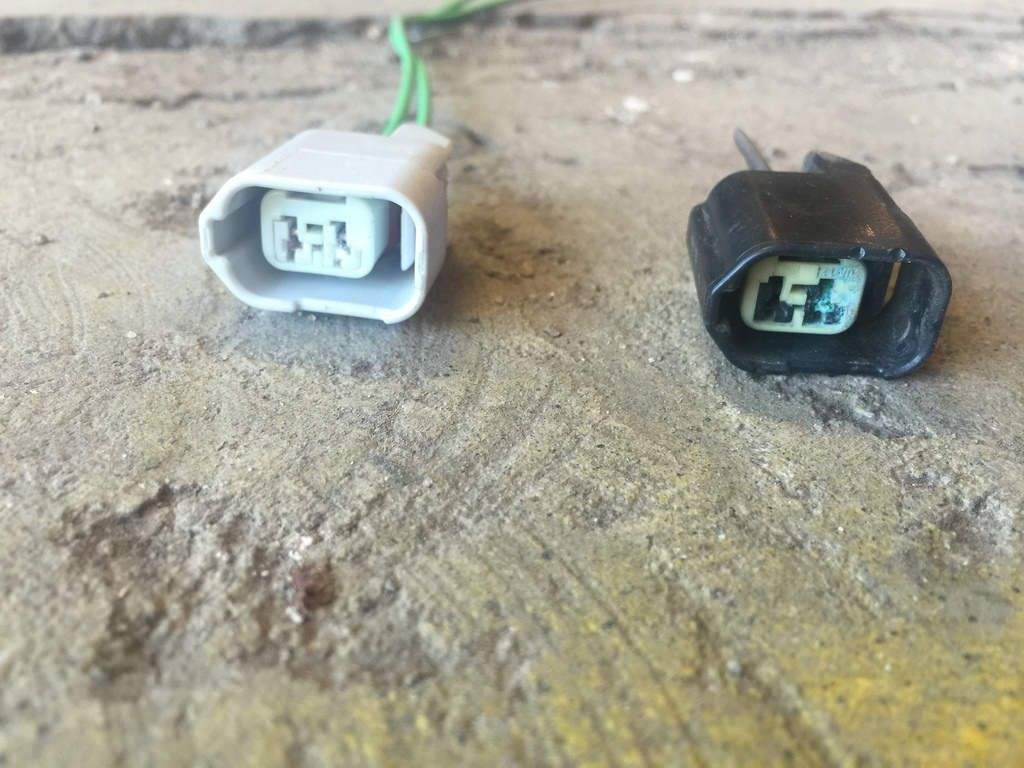

Licence plate wiring repair.
I had one licence plate socket that required replacement. The original connectors were corroded.
Left = New socket. Right = Corroded socket.
Weather sealed.
I had brand new led licence plate lights that I swapped to. I like to replace bulbs with LEDs for reliability over cosmetics.
Left = LED Right = Stock

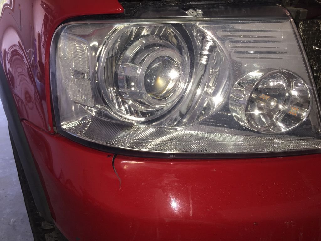

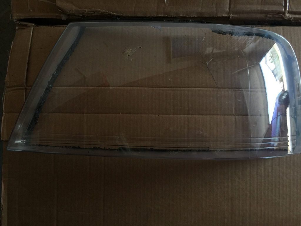

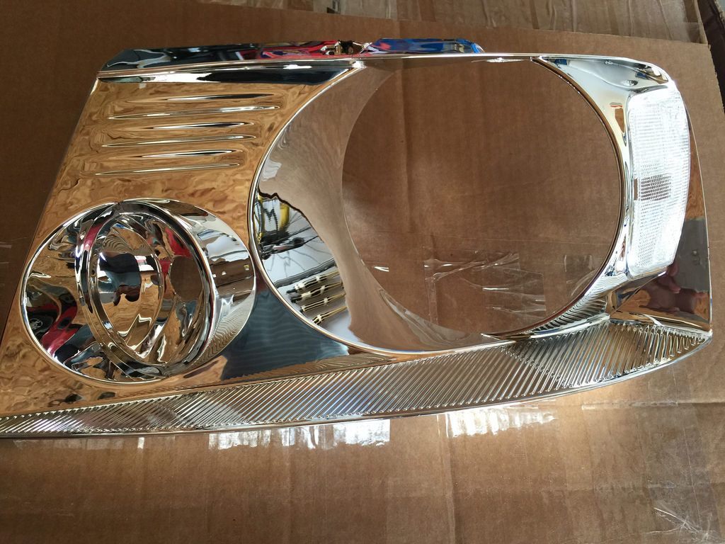

Headlight lens replacement.
Headlight apart
Old headlight
Not in the greatest condition. Has a lot of haze but I prefer a hazy headlight than a cracked one.
Old Aug 19, 2015 | 01:55 AM
  #84
04FX4Kev's Avatar
Joined: Jul 2015
Posts: 174
From: Calgary, Alberta
Swapped lens over. Had to wait 24 hours for the butyl seals to dry on the projector headlights.

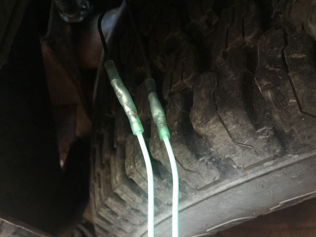

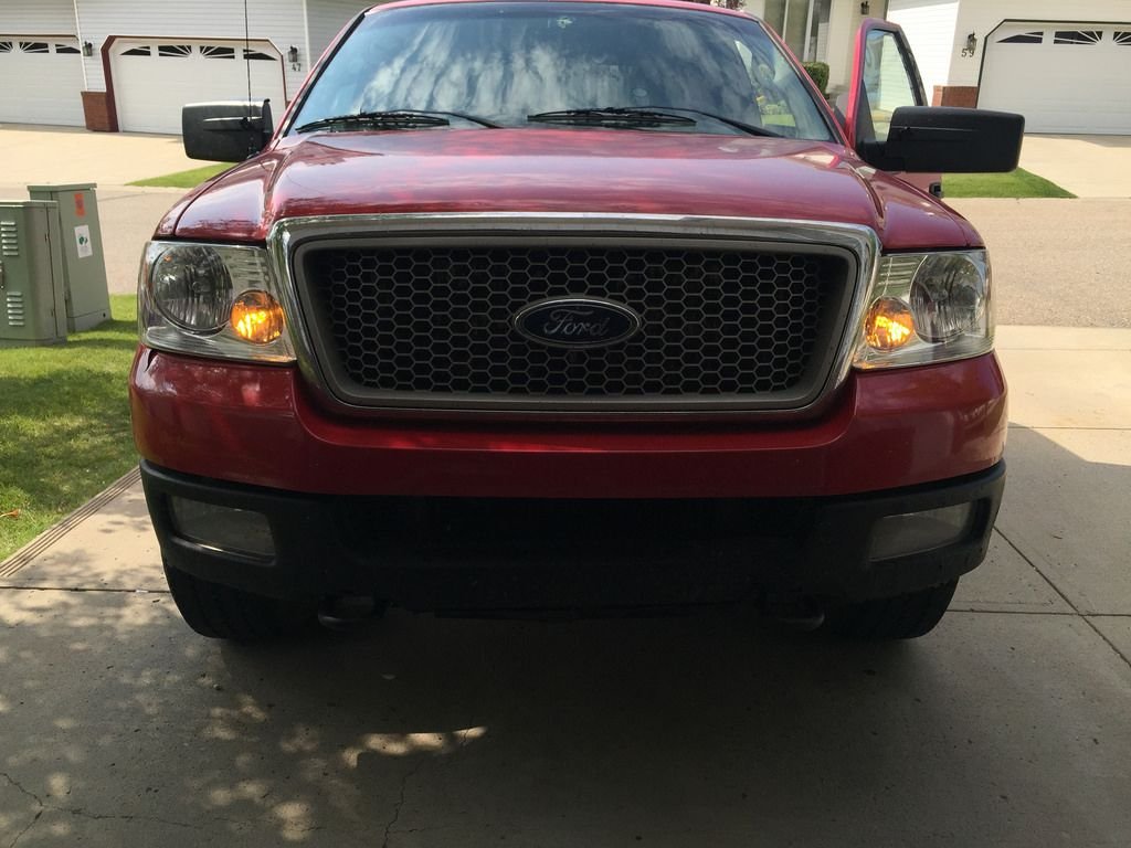

Wired the Low-beam DRL to Turn Signal DRL module.
(Purchased from http://www.webelectricproducts.com for $39 Model: DRL-1)
I normally solder and do not use these quick connectors but I will try them and if they stop working, I will solder them.

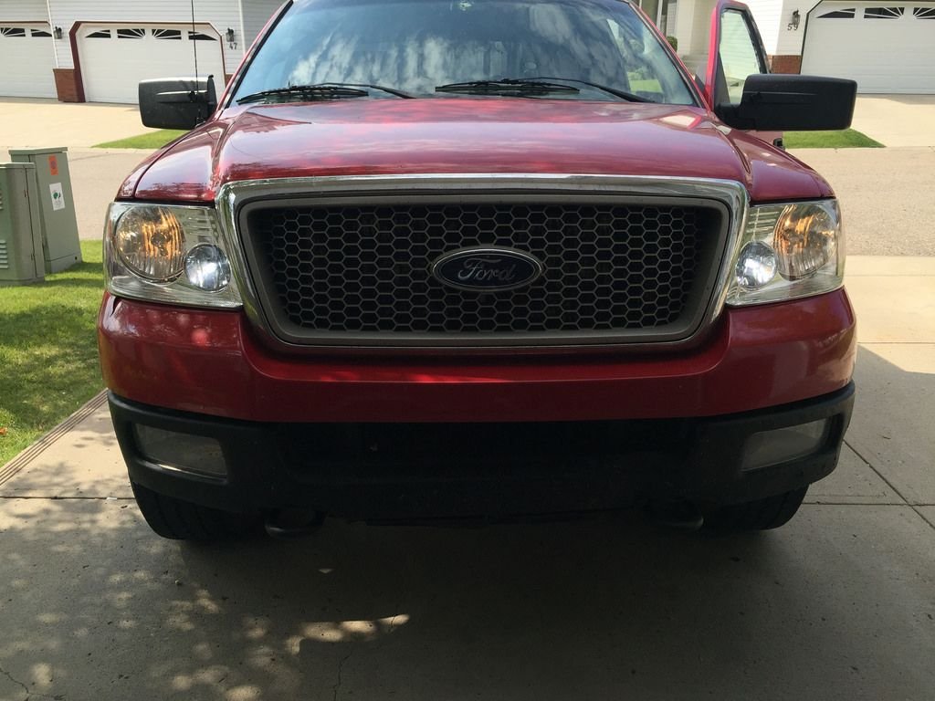

DRL Mode
Headlights On

Lens fully swapped over. Reconditioned them but did notice that the lights were sunbaked on the inside and did not want to touch the inside.
Before:
After (No cracks):

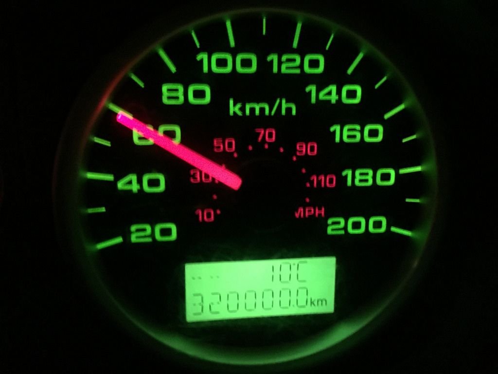

Hit 320,000 km today.
