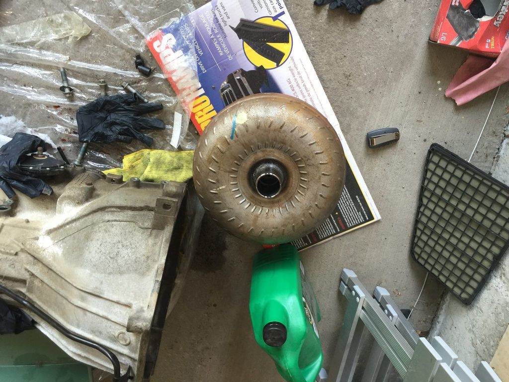

Picked this transmission up several weeks ago.
Came from a 2007 F150 Lariat with the 5.4L. Only had 120,000 km (75,000 miles).
Was a roll-over but the transmission itself is not damaged.
Picture of the torque converter (Got a new one. Will not be reusing this one).
Picture of the transmission, transfer case and front driveshaft.
Another angle:

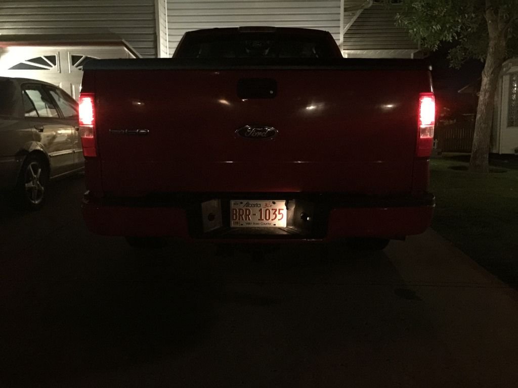

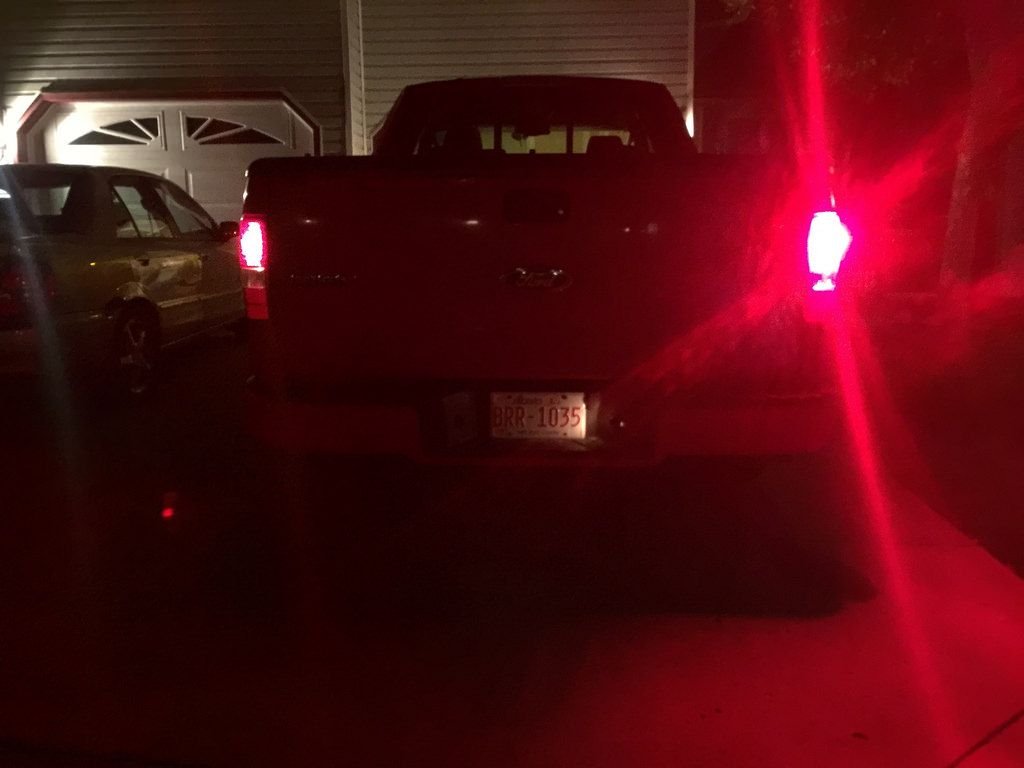

Completed LED tail light bulb conversion (1 bulb = Taillight + Turn Signal + Brakes).
I installed the EP27 flasher by Novita and I do not get any hyperflashes.
Pictures:
Left is old halogen. Right is LED.
Left - Halogen brake light. Right - LED brake light.
Left - Halogen sideview.
Right - LED sideview.
Nightview LEDs

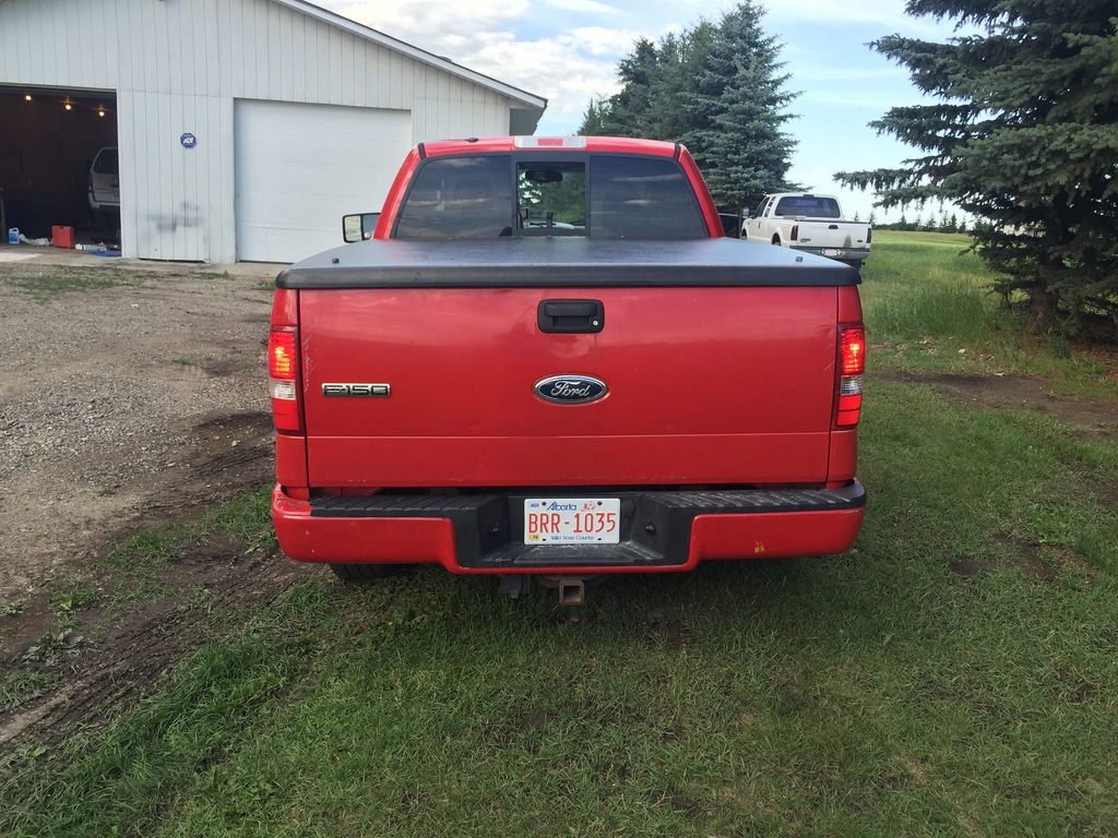

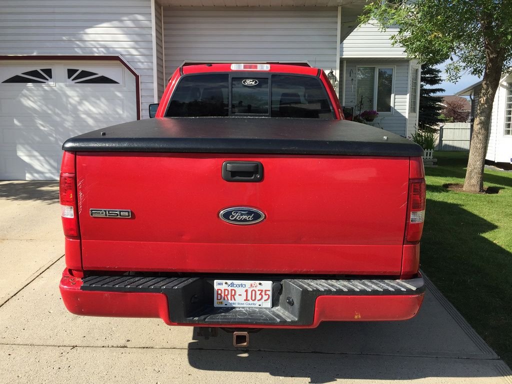

Finally, a couple of pictures of the truck:

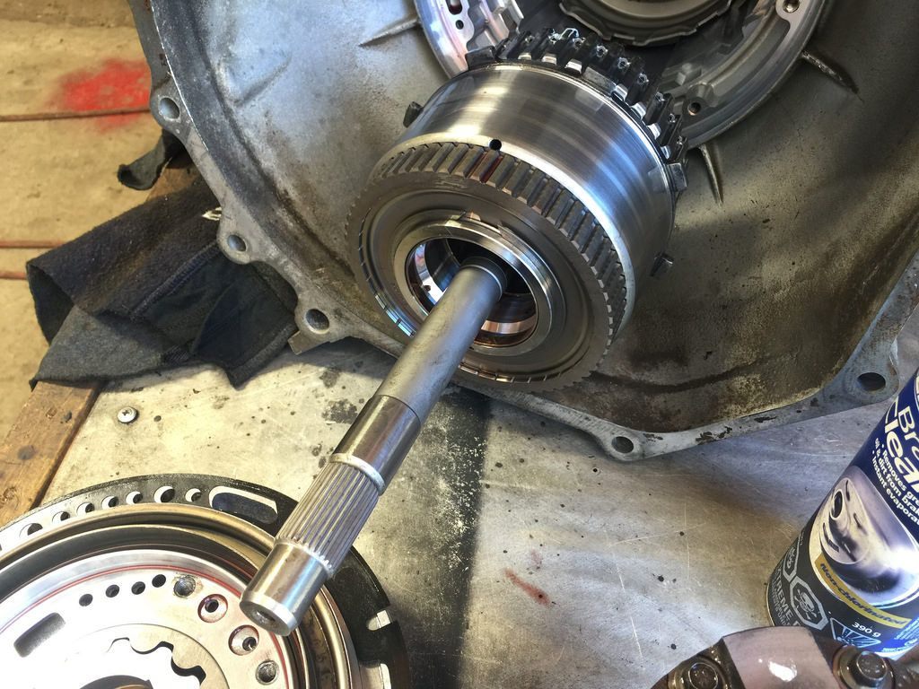

I believe this is the output shaft.
It houses the intermediate clutches and plates as well as the overdrive band.
