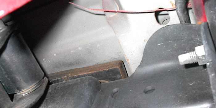

Here you go ......
Originally Posted by DanBBP
I was ordering a hitch for a friend on his 07 screw and the salesman asked if the truck had a vibration dampener, I asked what the @#*l is that! he said in 06-up Ford installed a dampener on some of the trucks! so I asked where would it be so I can check! He said in the rear by the frame, you will know it when you see it! and ive noticed alot of different variations of factory hitches on same trucks but different years, this makes me think that thier is some kind of dampener on some trucks but I have yet to see one!
I do know this isnt anything new to the auto industry because in the 60's and 70's vibration dampeners where in alot of full size 4 door sedans, they where in the trunks!
something to think about!
Pics of the weight as it sits on top of left frame rail near extreme rear of truck under a 2007 Ford FX4 Scab 6.5 Flareside.
Looking straight up from ground, outside of frame rail, you can see the rear shackle and rear of left side rear leaf spring in left edge of picture to the right is the rear underbed cross support.

This picture and the one below it were taken by just holding the camera up inside the rear side and aiming.
Looking towards rear of frame from behind left rear tire
Looking across at front end of weight from same area behind left rear tire.
There are only two of these bolts going through rubber isolated mounts.
No doubt but that the rubber density and sleeve length and bolt torque are all very precisely tuned to perfection because ...
... I don't have any bed shake.
I tried it.
Must be a Styleside malady?

Thanks for the pictures. If that is mounted to the top of the frame rail, then I know it is there to solve my problem. The physics just make sense. Now the question is, where can I get one and will it work on my truck.

Maybe it will. I looked, there is none on the right side, just the onne on the left. Just two bolts. I was poking some fun at the Styleside folk above in my last post, but even as late as June 2007 Ford was putting them under some trucks still ... at some costs ... for some reason.
It's certainly big enough to dampen harmonics.
Any "Pic-N-Pull" yards near you.
It's certainly worth a try?
EDIT:EDIT:EDIT:EDIT:EDIT:EDIT:EDIT:EDIT:EDIT:EDIT: EDIT:EDIT:
Just because I'm such a nice guy and all, I just went out in to the winter night across that cold driveway into that cold carport shed and with my genuin 2 D cell Maglite (LED) I scoped out a little more.
That weight is near 5" or more wide .... more wider than I first guestimated.
Also, look in the lower picture of the three in my last post. See that "diamond" shaped hole there on the left in line with what is the front bolt holding that weight on? You will have to go through that hole with a medium deep socket and ratchet to secure the nut, ... maybe a swivel and ext and keep the ratchet outside ... and use a wrench with offset to latch onto the bolt head up top.
I'm guessing about 15mm. Take a set of 14s and 17s to be sure .... but I'ld say it's 15mm.
The same goes for the bolt head of the rear bolt, but the nut inside the frame rail can be easily accessed through the rear iopening of the frame rail once the spare is out of the way I think.
All real easy if the bed is off as well. I think once the nuts are off that it'll rock over and the bolts come out. When putting back, I'ld almost try putting bolts in from inside frame rail and nuts on top?
My guess is it's gonna weigh some more than 10 pounds.
