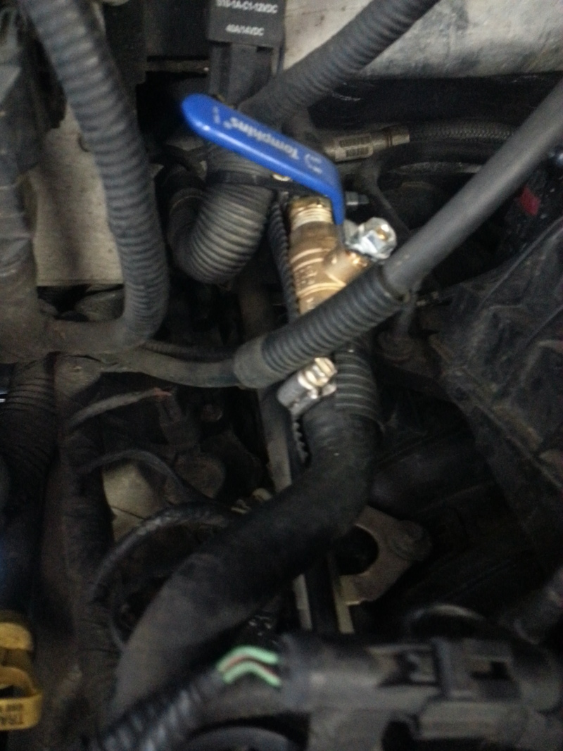

ac started to feel like it wasnt all there, so i pulled the system down and recharged it. we recovered .88 kg's out of it and its supposed to hold 1.02, so i probably have small leak somewhere. ford tech buddy said common problem is the compressor seal around the main shaft, so that means new compressor is in my future. oh well. 135k and still going strong i cant complain. so with the correct amount of refrigerant in there i added a ball valve to the heater core
and now the ac is freezing. havent found my ac thermometer but its very cold. for those wanting better ac performace i suggest this mod very much. your blocking water from going to the heatercore which keeps heat out of the dash and away from the other ac components which yields colder ac output. only drawback is no heat while you have the valve shut. shouldnt be a big deal if you time it right, youd only be changing it twice a year, opening it when it gets cold out, and closing it when it gets hot. its a 3/4 inch hose, and you put it in the one that comes off the front of the manifold and runs back to the heater core. 3/4 inch OD barb fitting valve is what you need. i bought a 3/4 inch ball valve from lowes and the od of the fittings was 5/8ths, so i dont know what was going on there, i ended up getting a valve and two thread in barb fittings at a brass fitting/hydraulic line place, but at any rate the barb fittings need to measure 3/4 inches outside diamater.
now if you wanted to get technical, this does not hurt the heater core. lots of ford products have this feature, its called a heater control valve
http://pictures1.kyozou.com/pictures...0/18449739.jpg
that is one off a superduty/excursion. it comes that way factory, a vacuum line off the recirculate button activates it (correct me if im wrong, this is how ford technicians explained it to me) and it shuts down coolant flow to the heater core. if ford didnt think it would corrode your heater core, then you dont need to worry about it. not to mention there isnt anywhere for the coolant on the back side of the valve to go. it should just be hanging out in your heater core, i.e. i dont think it drains out and leaves the heater core empty.
that valve is pretty cheap, but i have auto climate control and im not sure if it goes into recirc mode on its own, so i didnt go that route because i didnt want it killing my heat on me in the winter time. those of you with non auto climate can probably find the vac line for the recirculate and tee in another line to feed said valve i posted.

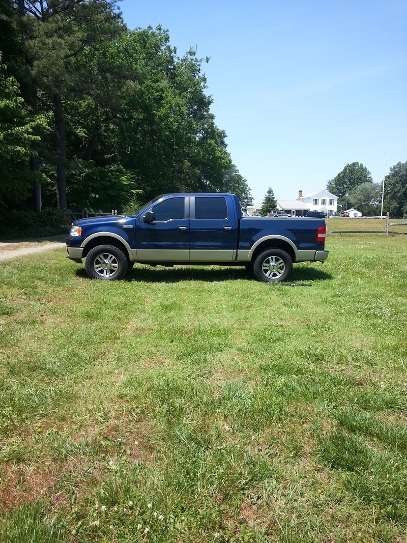

and tinted the windows darker. this is 5% on the front doors (meters at 4) and 20% over the back privacy glass (meters at 4) and then the windshield is untinted but has a 5% strip across the top. im very happy with it, i may go to 50% over the whole winshield and no strip but we'll see.

Did you put an AAL back there? Or you just not on level ground? The stance looks better than before!

must be the ground. i have nothing done to the rear, factory leaf pack and block.
the quicklifts brought the front down about a half inch from my 2 inch autospring spacer, which somehow gave me 2.5 inches. quicklifts gave me 2 even.
it sits right now, on flat ground it measures within a quarter inch from front to rear. still squats a bunch when pulling a car so airbags may be in my future

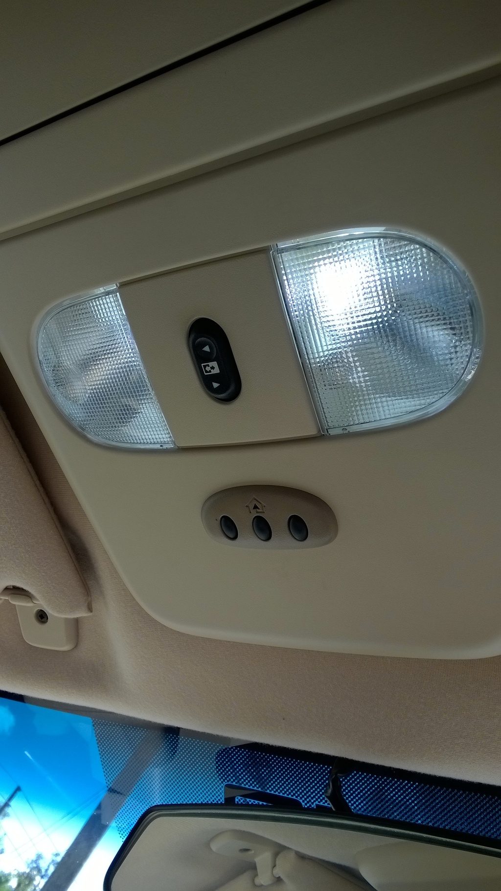

I didn't really take any progress pics but over the course of last night and today I installed a Homelink unit in my truck. It took a little doing but it was worth it and I'll never have to move our garage door opener from car to car again.

Where did you get the homelink?
