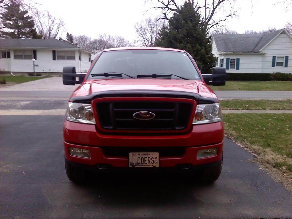

here we go only took like 2 hrs, and got my heat,turn, power and the puddle lights to work
