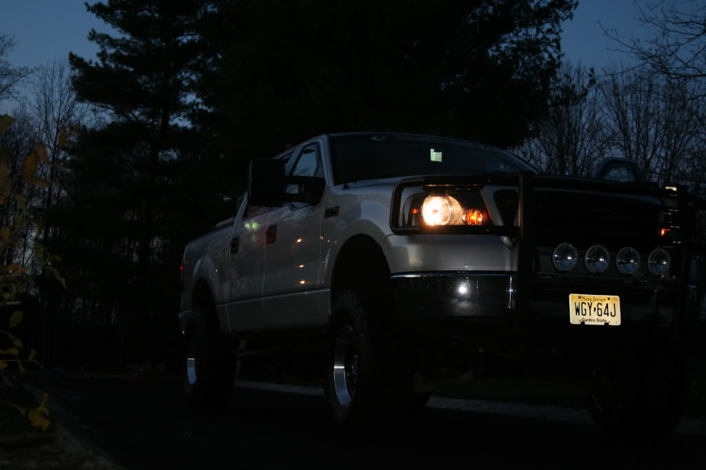

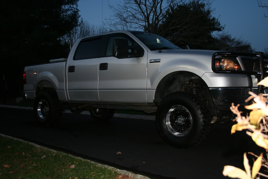

well i got the mirrors on last night sorry about the photos i no its alittle dark will be taking more when its nice out
i think they look good and it will help alot when im trailer the boat

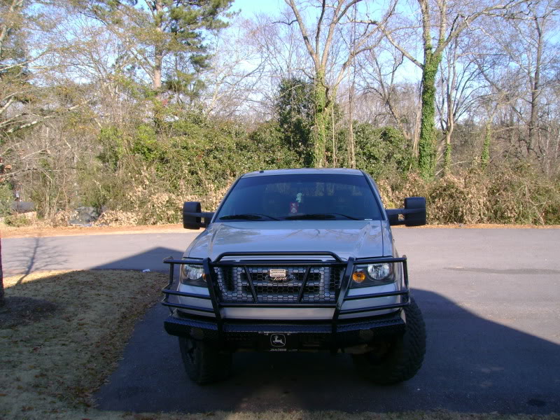

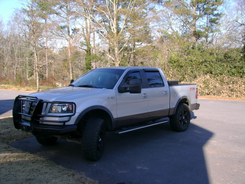

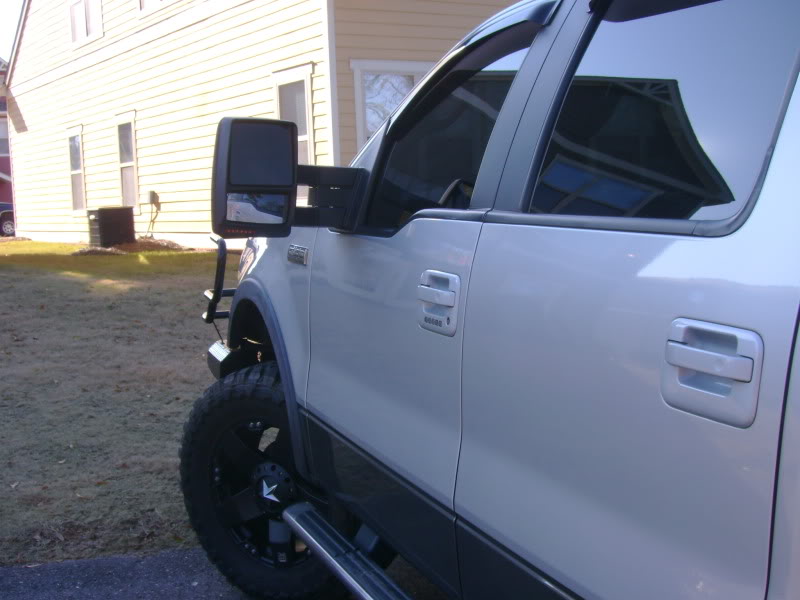

FINALLY got mine
