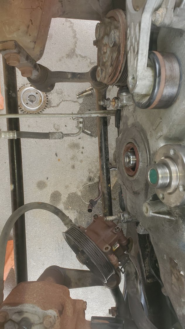

I almost made a mistake I saw someone else on Facebook make... Note the crank trigger tone ring still on the ground.
At least, when I saw it, there were only a few bolts in and not even finger tight. Easy to recover from.
