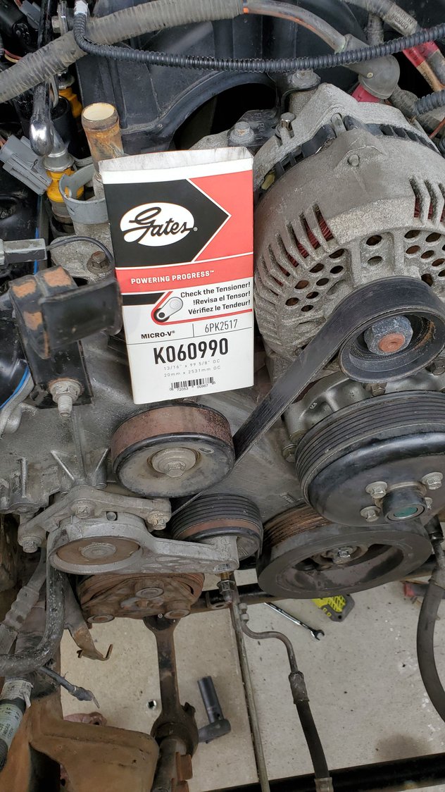

The belt claims 99 5/8"... To me, it needs another 3/8"... But I finally got it on.

should make for an easy removal of the starter bolts after the starter is broken off and out of the way
If you ever have a really tight belt like that, loosen the tensioner mounting bolt(s), there's usually enough "tolerance" to be able to "clock" the tensioner slightly one way or the other to make life easier

Yep. Bolts came out easy!
I got the belt on, but that is probably the tightest belt I've ever put on. A vehicle... I used to have a 54" waist, belts were not any fun. Down to a 38" again. Now I have a couple too big belts!

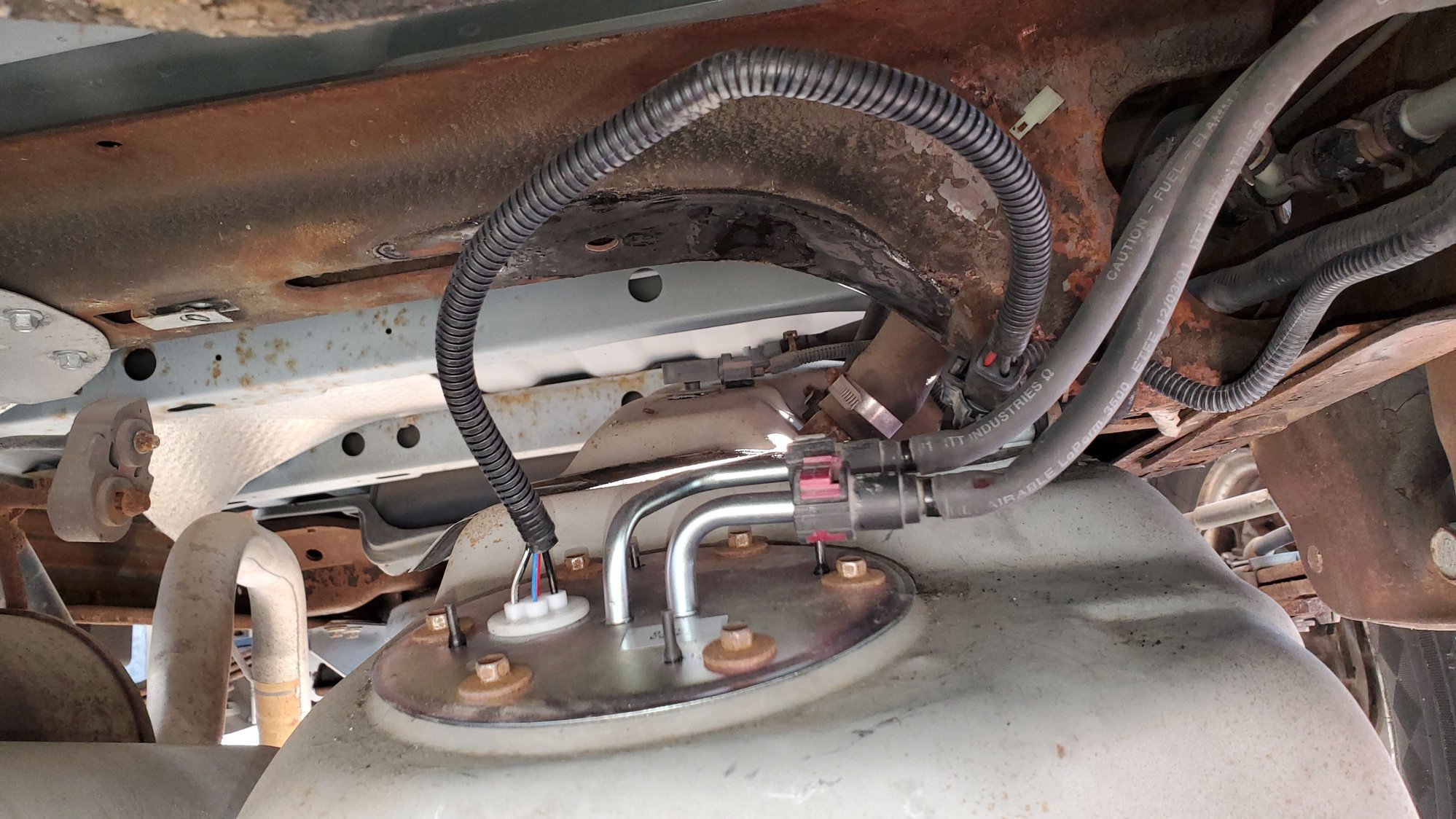

Starter went in easy. I hadn't installed the starter to battery harness properly, so took some time to get it right. And then tried to start it. It cranked, but didn't fire. Grrrr. No fuel pressure. So changed the fuel filter, hoping it was clogged. Nope.
Double checked that inertia switch connection, and for voltage. Checked fuel pump fuse and relay. That left... Fuel pump. I tried whacking the tank with a rubber mallet... To no avail..
Watched some videos, and ran into a snag...
These connectors are not the same as the videos, or under the hood, or even the filter! Kicked my butt they did...
Once I figured that the clips didn't need tools, they popped right off. But it was an ordeal.
I didn't drop the tank all the way out from under the truck. Front is still high on jack stands, so I was able to get my formerly fat self under there to work, and enough to angle the old pump out.
I kept the rear supported and it all went back with no issues. I primed the pump without the filter connected, and that was successful. So, reconnected the filter, primed the system a few times and tried to start. It cranked a few times, but, started. And I'm happy. Open exhaust made for a little disturbance of the peace, but nobody called me in...
