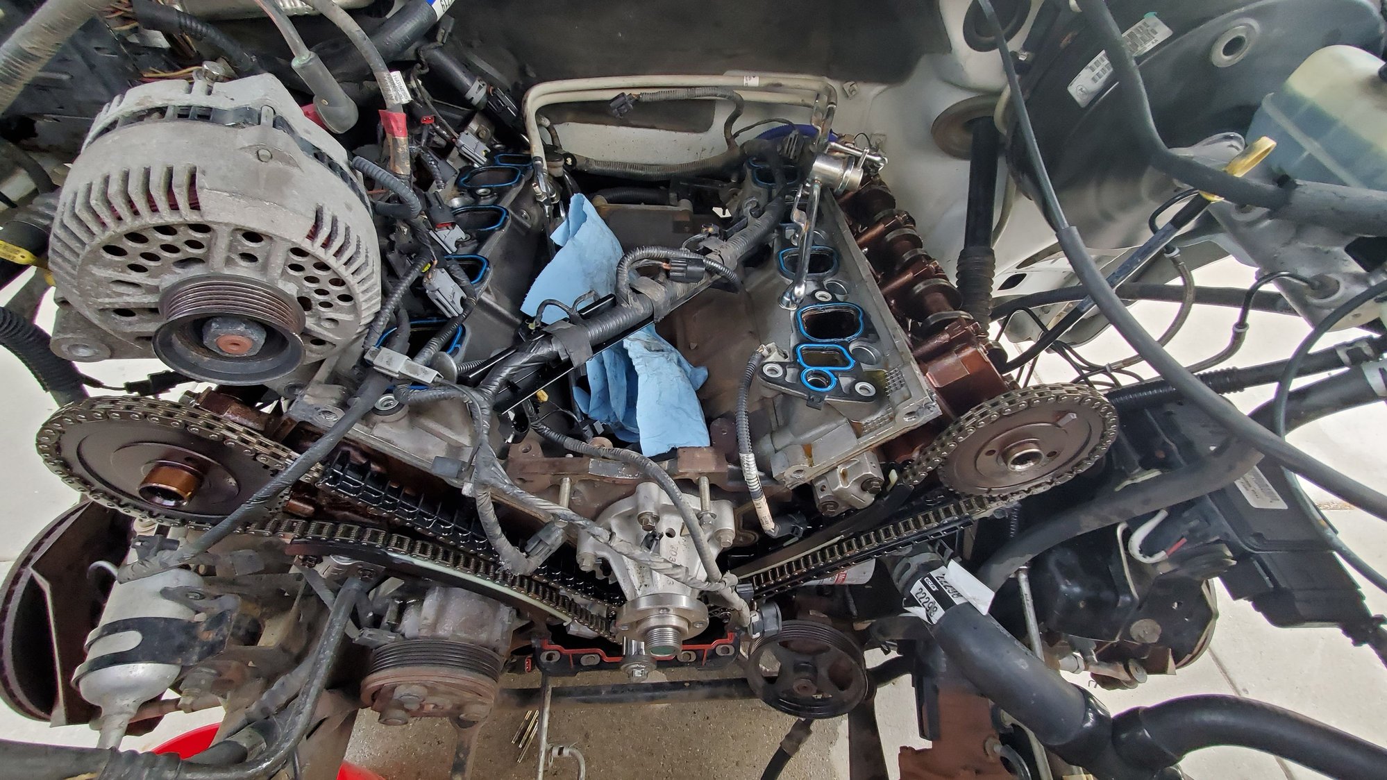

I'm down to setting timing before pulling the head. The head from the original is still resting on it's original block. But loose. Had numerous distractions from my wife, or at the least, the other head would be in place. Well. Breaking a 1/4" drive ujoint meant a trip to the store, and yes. Misplaced 10mm and 8mm sockets. After 3 trips to the parts store,, of course,, the sockets reappeared.

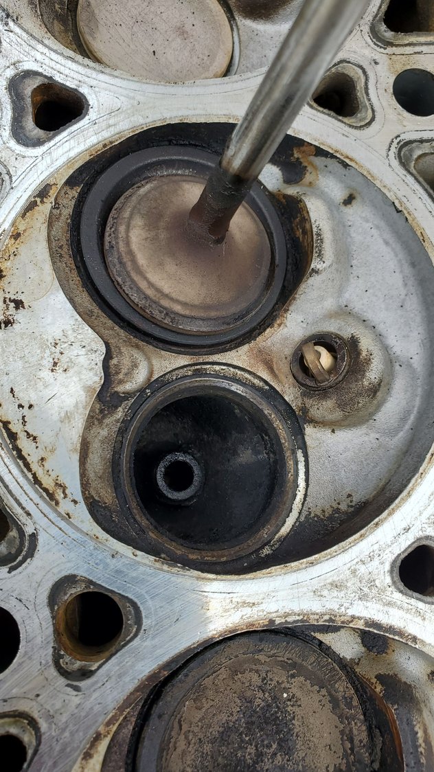

Now I wonder, how an engine I heard run, granted 6 years ago, had enough buildup on the exhaust valve seat, to not seal. Perhaps as long as it sat, this exhaust valve was a touch open and condensate of many sorts formed? I have little doubt running any sort of top cylinder cleaners or any fuel system cleaners would have resolved this.
Interestingly. I had the chambers sitting visible. Pulled the cam. Put in a spark plug and filled the combustion chamber with water. After 15 minutes, the exhaust port was still dry. After an hour though, the chamber was wet.
Looking at all the valve seats on my old head while prepping it to go back in service...
Well. Going back together...

If you have the time and inclination, you could lap the valve seats a bit.
Old Jun 4, 2020 | 09:21 PM
  #75
poor mans valve job. a little grinding compound, and mount a drill onto the valve stem and spin away into the head
