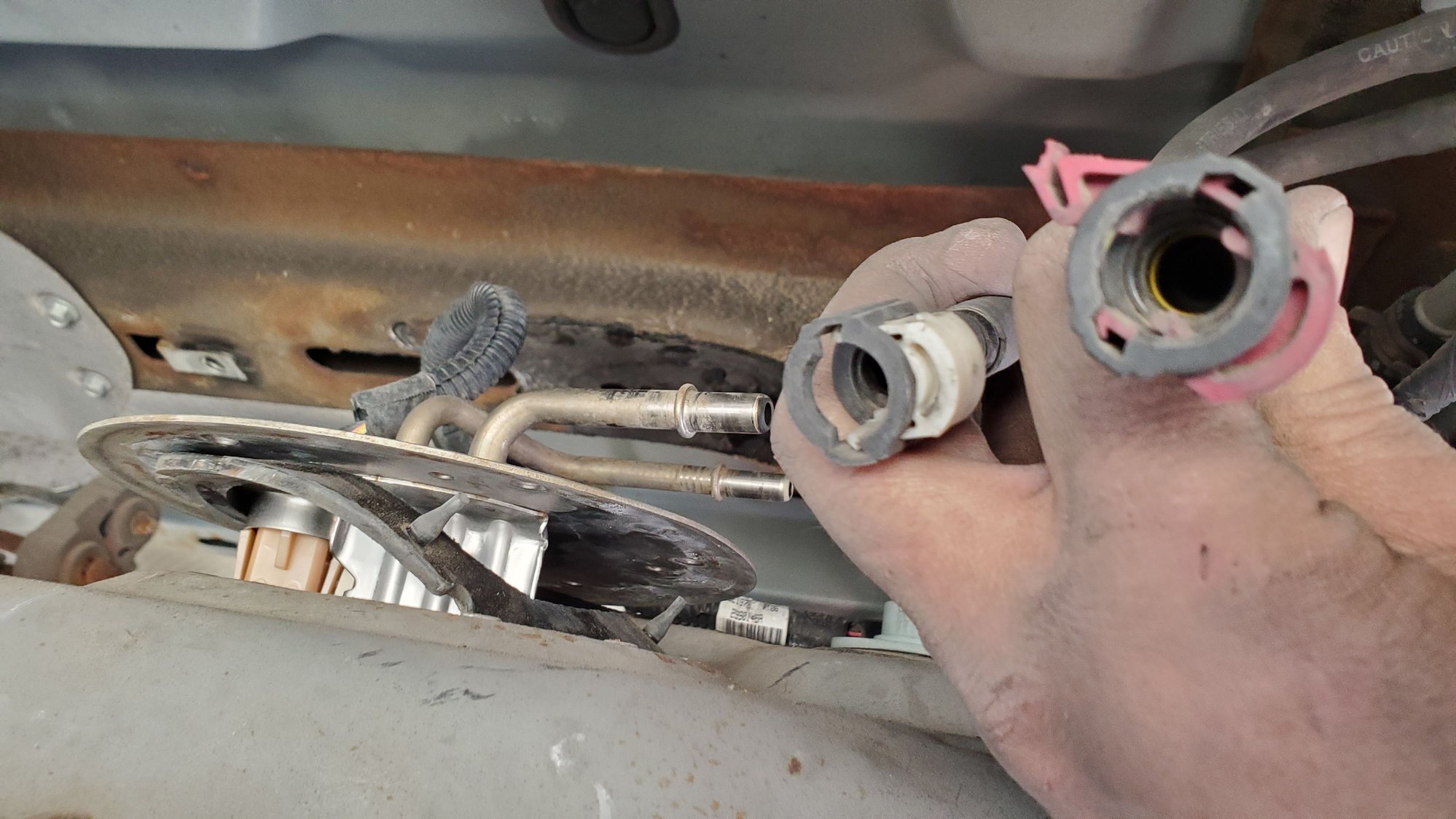

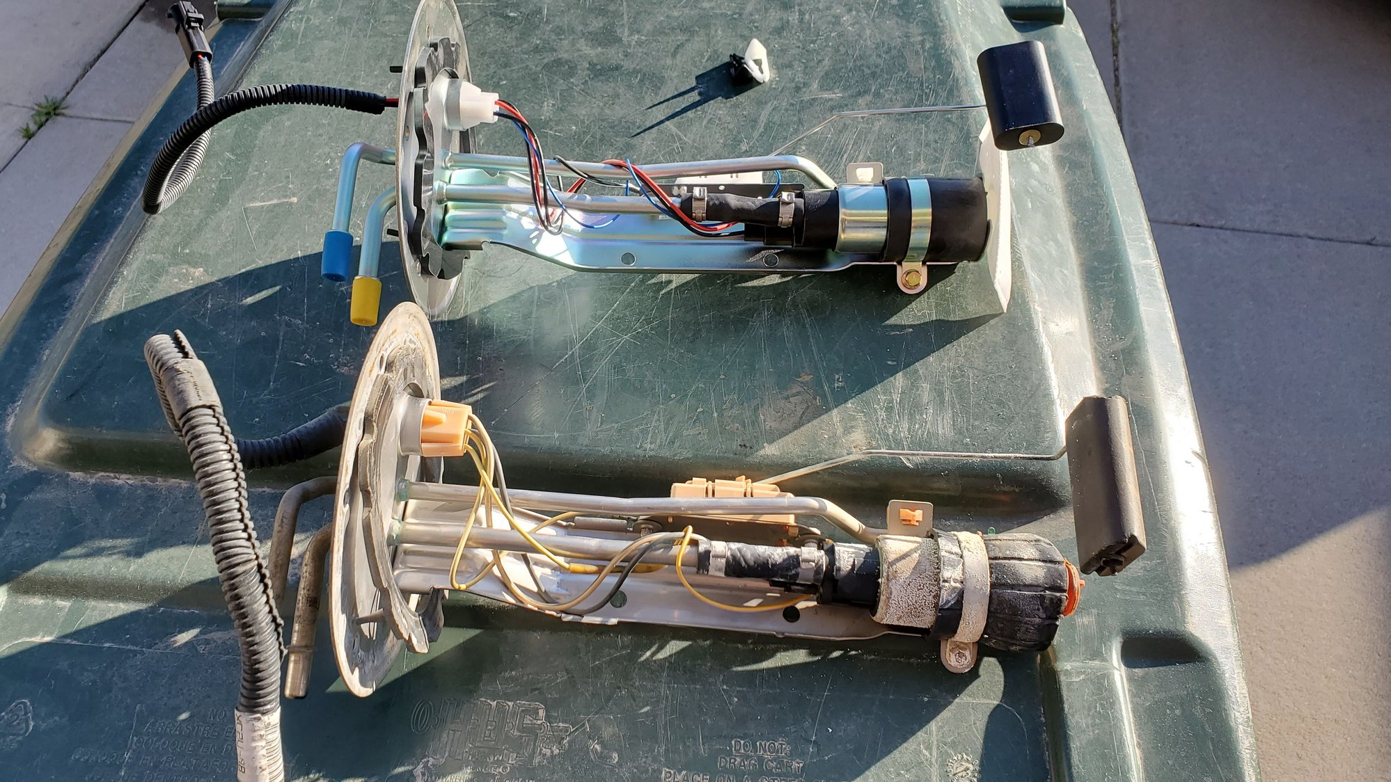

I appreciate that video. But I just did this about 2 weeks ago...
Managed to not drop the tank all the way. The fuel connections were different than all the videos...
That threw me for quite the loop. I was surprised to see the above video had the same connectors as mine!
So I'm questioning replacing the entire assembly, it is under warranty, or spend the extra money to upgrade from the budget pump, $85. Motorcraft pumps are pricey. Or. Maybe get a Holley or Walbro bare pump and fit it to the assembly. Had I kept the original, that might have made my decision easier. But it was frozen. No amount of hammering got it to spin again. And no. It didn't look like the starter afterwards. Lost my core charge on that. I will also change the fuel filter again regardless.

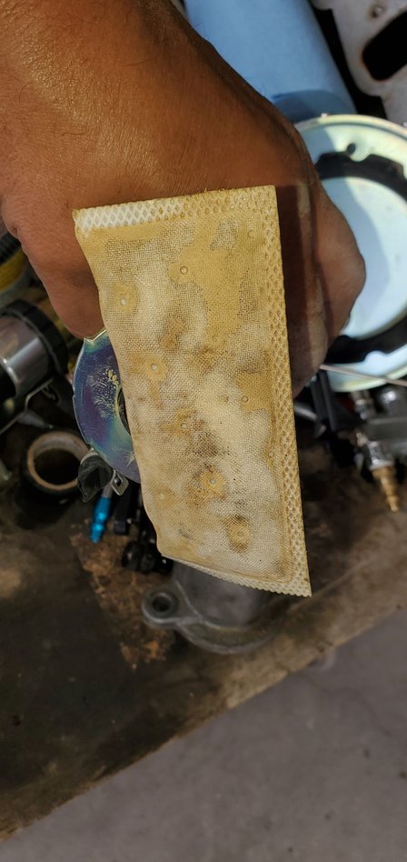

I'm betting the pump is probably ok, but the filth in the tank is the issue..
So. Best way to clean this tank out?

If that pump sucked up some of that crap I wouldn't trust it or the filter. Is that tank metal or plastic? I aasume you have removed the tank completely.
New tanks are only about $130 at Rock Auto.

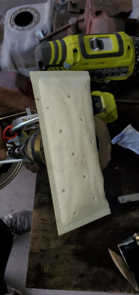

Filter and pump will both be changed. New steel tank will be here tomorrow. I love Rock Auto, but they can't get here tomorrow. New tank equals Peace of mind.
Yes, that pump is only 2 weeks old. As soon as I saw that sock filter, I dropped the tank. Since the truck sat 7 years, all the fuel evaporated. I put in new fuel, added Seafoam fuel system cleaner then added Techron. So that broke up all that debris.
New tank, New pump and filter. This should run like a scalded skunk once again. No more fuel starvation...
