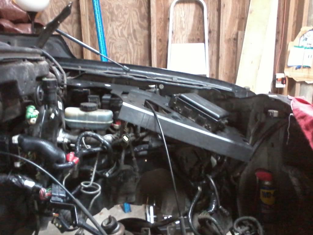

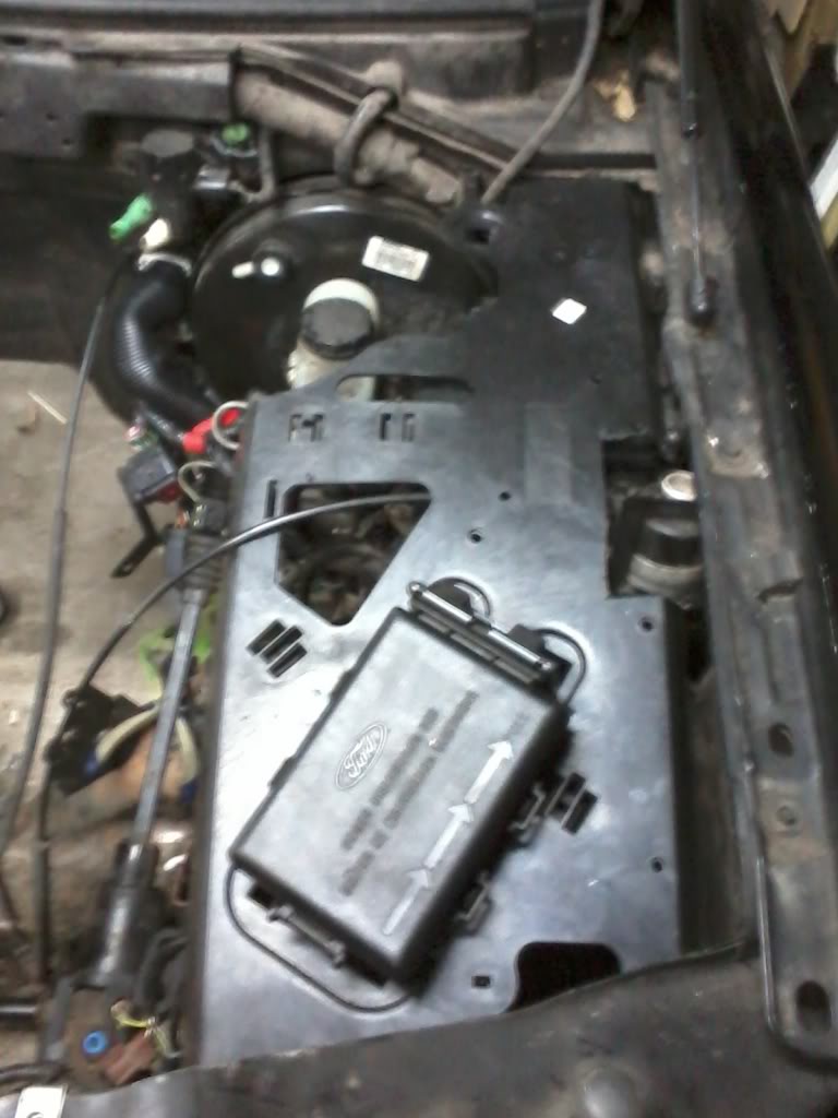

Mounted the engine bay fuse block today..
I had a piece of heavy plastic that came out of the Mk8, under the rear deck. (It held the amp and some other mystery box)
I got to looking at it and decided it best to recycle, so I made this...
