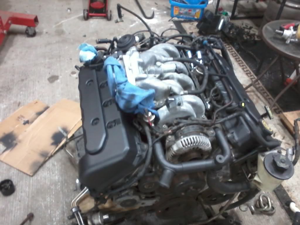

Quick update-week 3
So everything is set for the truck to roll in, gotta fab up some motor mounts, and maybe spice a few trans wires. Got the motor and the trans serviced and detailed. Pressure cleaned the F-150 top to bottom. Straightened up the shop, and did a tool inventory..Only lost about 10 snap-on's. FML
With turkey day coming, I don't expect to get alot done this week, but that's been said before and we got a ton done, so...we'll see.
Anyway here's some eye candy for ya'll.

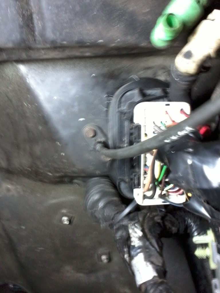

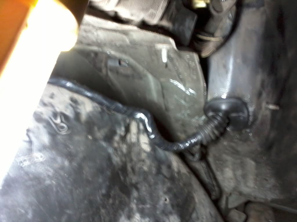

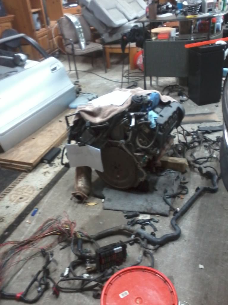

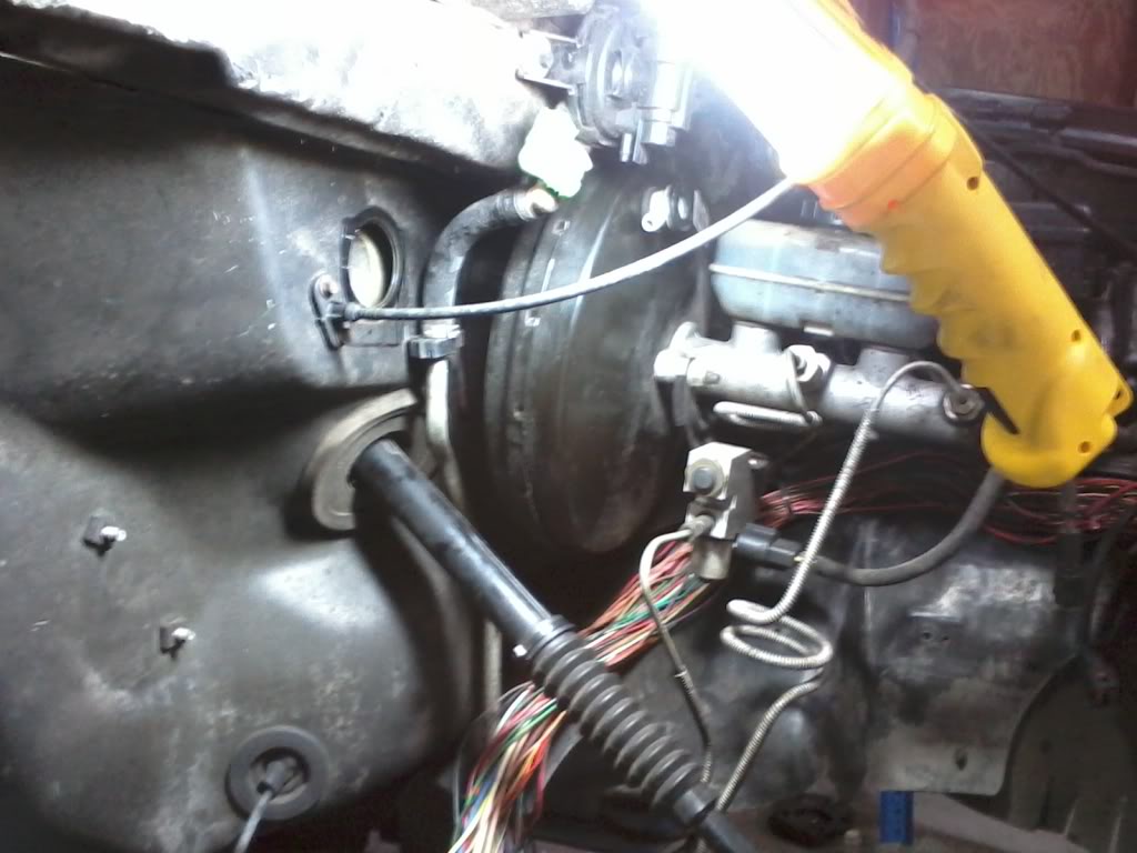

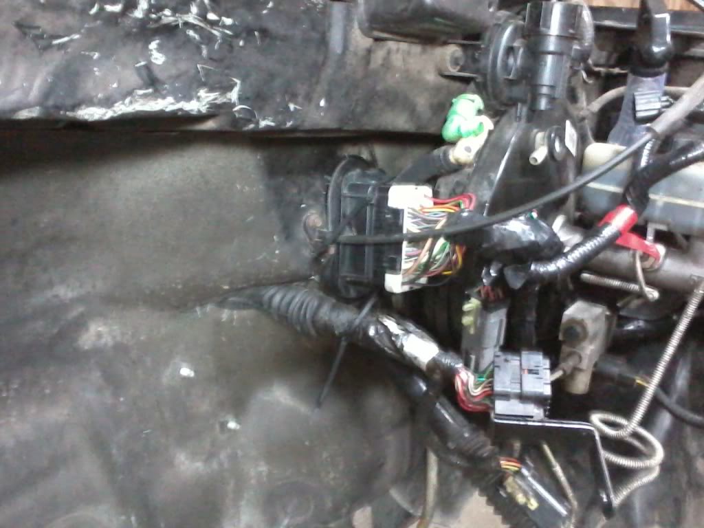

The holidays slowed progress some, but we got the thru firewall wiring done and about 80% of the behind dash ready for testing. Motor mounts are fighting me. Does anyone know a place that could custom make mounts for this application?
