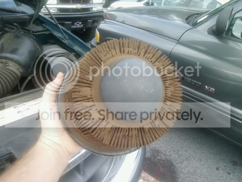

Originally Posted by chester8420
lol sure is clean! my grandpa use to say it took me 5 years to get it that dirty why u gonna throw it away
