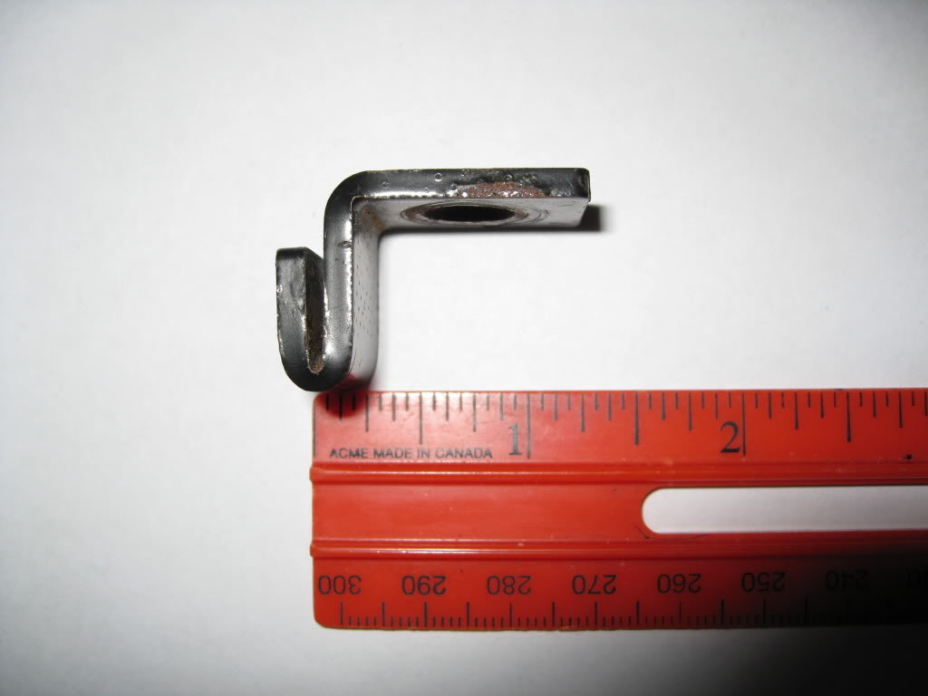

Here is one that came off of my Troyer set-up. I think It's the same one DM was using, I don't know what happened to him either, seems to have just folded up his tent and left ???? That piece is 3/4" wide stock.
