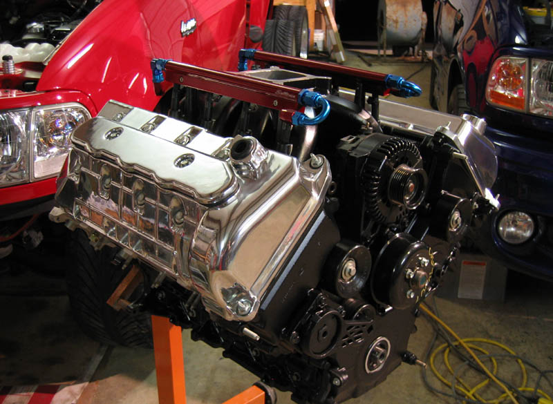

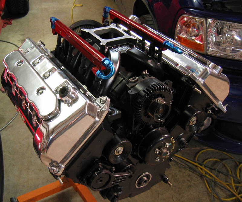

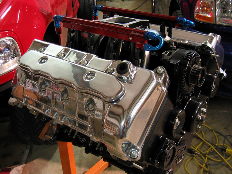

Old Jun 29, 2005 | 02:26 AM
  #101
ShockTherapy's Avatar
Joined: Jul 2004
Posts: 704
From: Arkansas
OK, how about a couple now that I picked up my passenger side valve cover today? I also put my injectors in the rails, and made some spacers so I could use my stock Lightning 8 rib idler pulleys on the NAVI front cover. I'll be working on splicing the Lightning and Navigator engine wiring harnesses together Wed night.

Old Jun 29, 2005 | 03:38 AM
  #103
ScrewOnBudnik20's Avatar
Posts: 169
From: Dallas
Looking very good. Look at the alignment of your intake manifold gasket against the sully intake the water outlet hole on my drivers forward barley lines up. It would have been an issue for sure. I'm going to weld some filler in there for the gasket then smooth it out so it can seal. Also I'm curious if you went with the 2003 cobra head gaskets for your install as I did.
