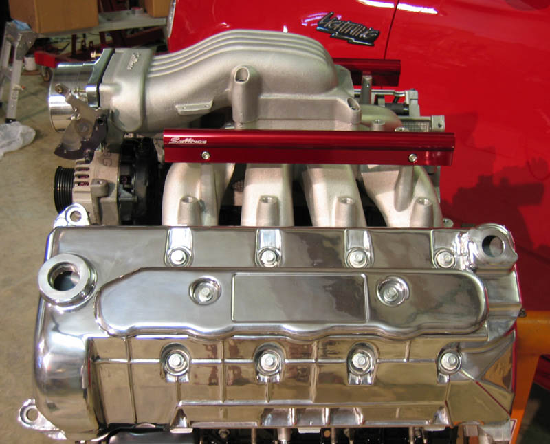

I test fit a few things tonight so I can start ordering AN fittings, etc for my fuel rail setup. I also picked up one polished item today as well.
I about lost my load when I picked the valve cover up today. The guy polishing them said he has over 15 hours into this one cover because the stock casting was really hard to work with. Here's that exact same valve cover in it's stock, raw form.

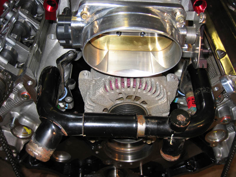

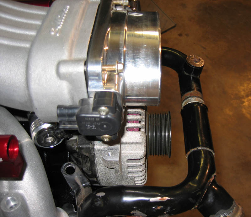

Hey your setup looks just like mine. Just curious what you plan to do for a water crossover and thermostat?
Water crossover and t-stat are going to be cobra parts adapted to my application.
That's a crappy looking crossover pipe I'm using for mock up right now.
The t-stat housing is actually in the middle of some radiator hoses down low on the drivers side of the engine. No pics of it right now.
Bling, bling!

I thought about that crossover for a time also. Any ideas on the upper alternator bracket?

Alot of guys are saying they don't run and upper bracket....I'm not sure about that myself but I have heard/read that.

I didn't run an upper bracket on my conversion and 15K miles later the lower bolts broke and the alternator siezed into the SC pulley bracket. The bracket was on back order last year when alot of people were putting the swap in and still don't have the bracket. Guess i was the unlucky on.
