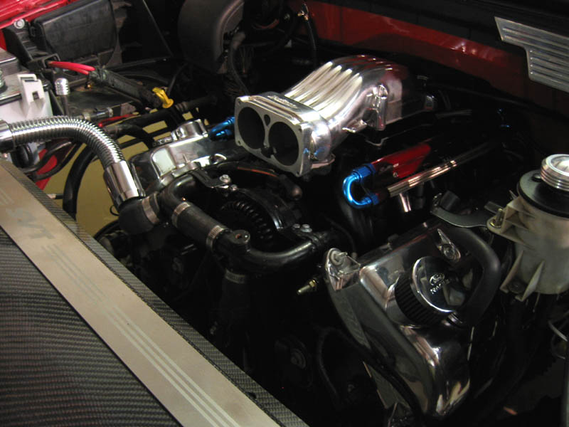

A few more I snapped tonight. I installed a set of NGK TR6's and put in the coil packs tonight. I also picked up a 1" carb spacer to raise the plenum, and bolted it down as well. It's getting really close to being fired up now.

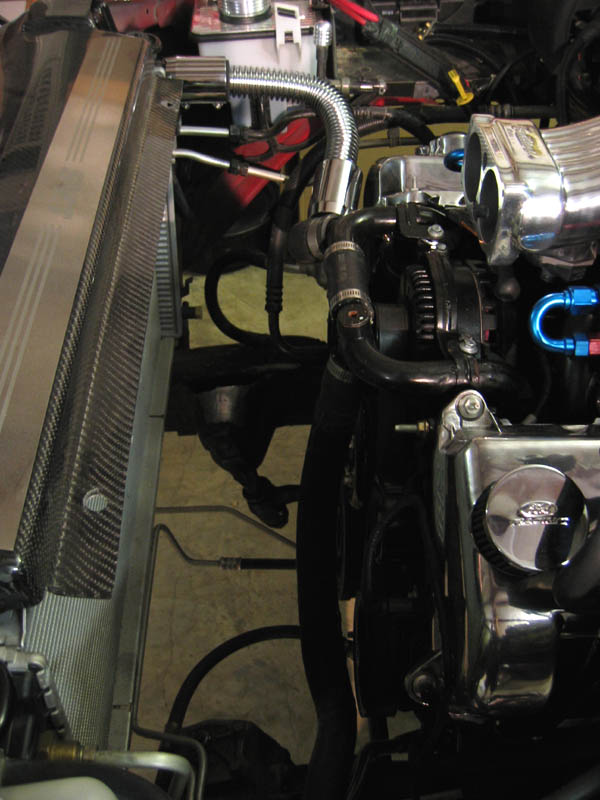

Update on the project:
Here's a pic of what looks like now. I'm uploading the videos and will post the links in a bit.
