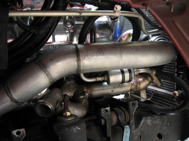

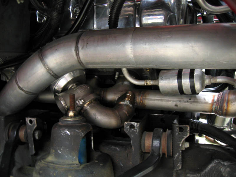

OK, a few pics of the partial pass side downpipe and wastegate.

hope your having all that stuff polished! and your gona melt that a/c line in a heart beat

All the hot parts will be coated 2000+ degree black just like the turbine housing is, and the A/C line will actually be between the header and the downpipe in pretty much the stock location.. It's not where it will be once all the plumbing is done.

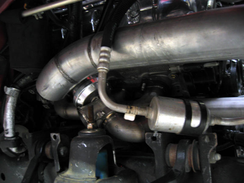

They didn't make Friday's deadline, I was a bit disappointed at that. I was down there today though and stressed how important it was that I get it back ASAP. It's coming along nicely though. They were able to fab the downpipe as a single piece, with v-band clamps on both ends for easy in-out. Here are a few updated pics.

Lord help that rubber shock grommet.

It's not as close as it looks, plus, all the hot parts are going to be 2000+ degree coated black the same as my turbine housing is.
