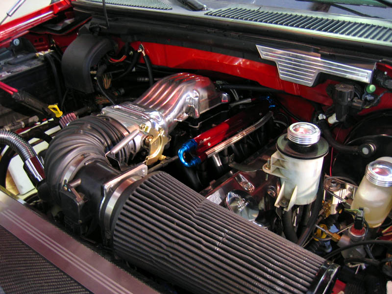

Old Sep 7, 2005 | 10:27 AM
  #258
31Charlie's Avatar
Joined: Mar 2003
Posts: 691
From: California
Originally Posted by ShockTherapy
You need to get rid of that ugly filter and get one of these:
31C
Old Sep 7, 2005 | 10:48 AM
  #259
35thPony's Avatar
Joined: Aug 2004
Posts: 624
From: Raleigh, NC
31C
Hey shock, I have one of those filters and oil kit that doesn't fit my JLP box, If you want it let me know...
Old Sep 7, 2005 | 10:57 AM
  #260
ShockTherapy's Avatar
Joined: Jul 2004
Posts: 704
From: Arkansas
Thanks guys, but that filter was just for temporary use while I drove the truck to the shop with no turbos on it. I will have dual chrome filters, each on the end of a 4" polished aluminum tube for the finished product.

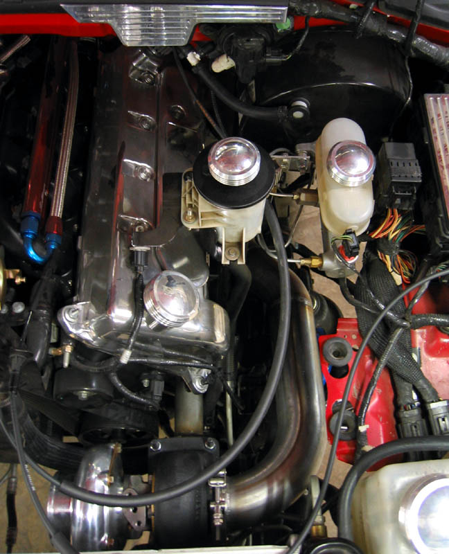

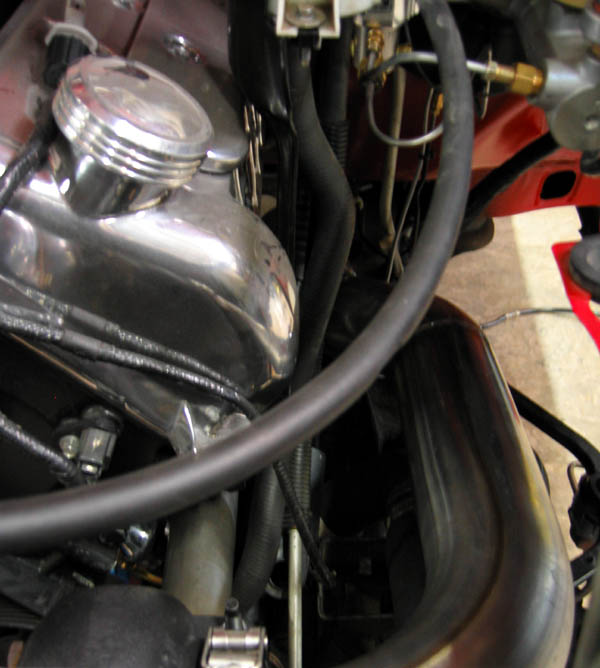

Old Sep 8, 2005 | 08:55 PM
  #262
Joined: Jul 2004
Posts: 704
From: Arkansas
It's getting a lot closer...

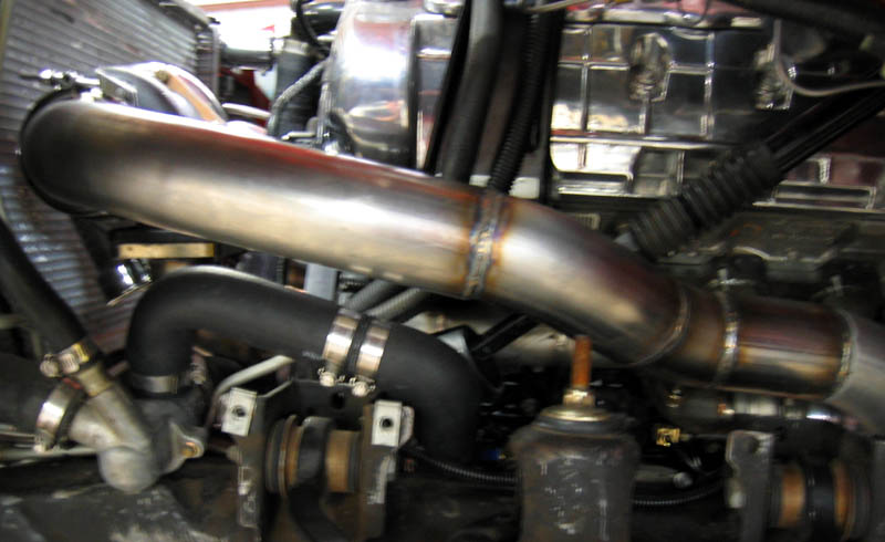

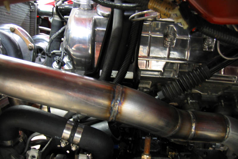

Old Sep 8, 2005 | 08:58 PM
  #263
Joined: Jul 2004
Posts: 704
From: Arkansas
Old Sep 9, 2005 | 05:09 AM
  #264
KB ZILLA's Avatar
Joined: Aug 2003
Posts: 908
From: Alabama
Awesome Shock....I knew that could be done.
I was thinking the other day that it would be better to carry the downpipe around the steering column than under the crossmember like the PTK kit. And now I see exactly what I had pictured (yes, I realize the ABS will have to be relocated or removed)

Old Sep 9, 2005 | 12:44 PM
  #267
Silver-Bolt's Avatar
Joined: Dec 2000
Posts: 3,451
From: Portland, Oregon. USA
Keep in mind Shock is running twin turbo = twin downpipe and the other one is a single. This is much cleaner. That downpipe under the cross member setup is a hack job short cut.

Old Sep 9, 2005 | 09:01 PM
  #269
Joined: Jul 2004
Posts: 704
From: Arkansas
Originally Posted by JMC
Shock,
Just a few questions. Is there enough room for the inner fender wells. It is hard to tell by the pictures but it looks very close. I would also like to know where you got the T fittings to make the header log.
Thanks
JMC
There is plenty of room for the inner fender wells. The driver side has about 2" of clearance. The pass side rubs in a few spots, but the downpipes will be coated with 2000+ coating, and I will also be wrapping the pass side one in a few spots where it rubs, and also putting a radiant heat shield in the same spot(s).
The shop doing my turbos bought the "T's", I don't know where they got them, sorry.
