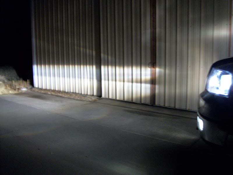

Nothing wrong with the MiniH1, you just can't use OEM equipment. I have both the MiniH1 and FXR on my truck. MH1 has better foreground, FXR has better distance. Both are about equal width with the FXR more intense at width. Both have a good high beam.
FXR on top, mini on bottom:

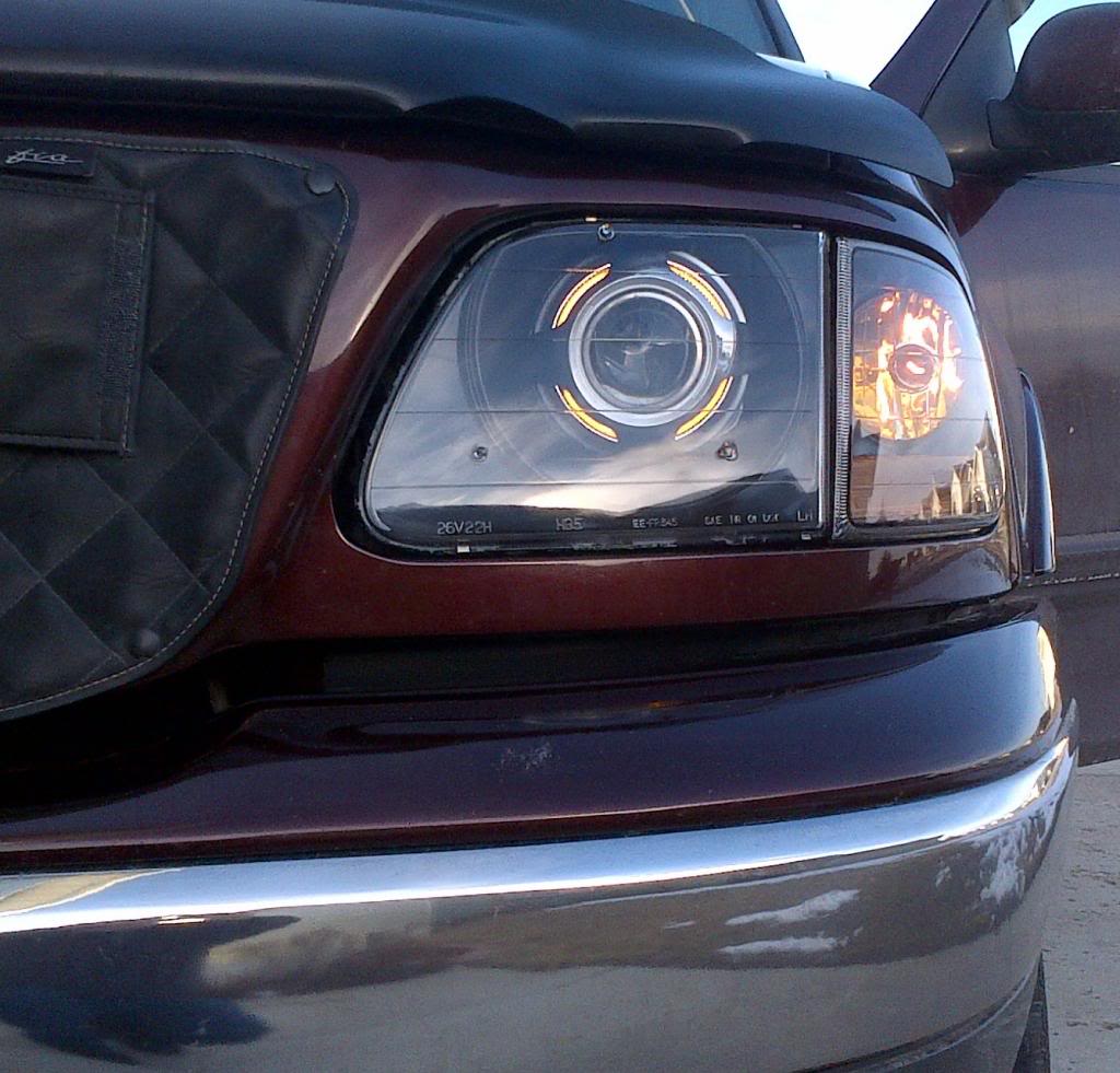

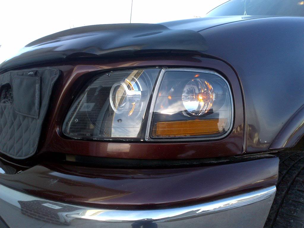

For my truck, I love my all black but the shroud and the corner light reflectors chrome. Name:  IMG-20130205-00663_zps5868ad5b.jpg
Size:  87.6 KB Name:  IMG-20130205-00654_zps0357e746.jpg
Size:  133.3 KB Name:  IMG-20130205-00664_zps9a081f3d.jpg
