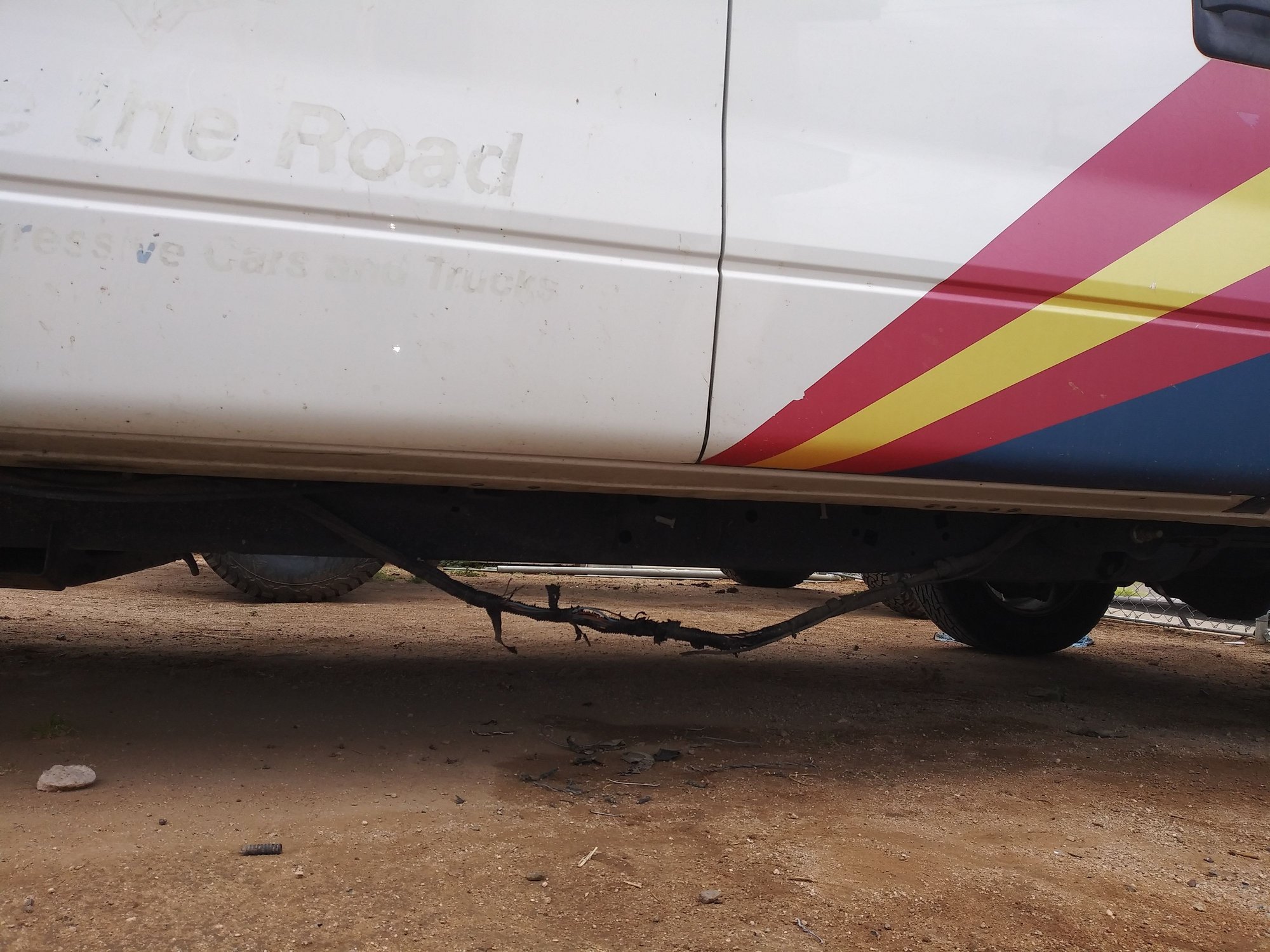

I just bought a 2010 f150, retired highway patrol truck at the auction. My pit bull chewed up the wiring harness that goes from the engine area to the rear of the truck. Does anybody have any idea what it goes to? And where can I get a replacement?
Old May 12, 2019 | 06:03 PM
JackandJanet's Avatar
Posts: 7,890
Likes: 61
If it's going to the rear, probably one or more of the lights back there? Is this a bundle of more than one wire, or is it a single wire? Can't you trace it back to wherever it terminates? Once you identify what it feeds, I'm sure you could get a replacement at a dealership if it's a multi-wire harness. If it's just a single wire, splice in a new section of ordinary primary wire .
- Jack
The harness has at least 25-30 wires in it. And I believe the abs lines to the rear. I followed it from under the hood, along the frame and it curves into mid truck right at the cab/bed. The smaller wires are chewed clean through, the larger wires are just chewed up. He actually pulled off all the anchor gromets off the frame where the loom was attached to. This looks like he actually planned it out.
Old May 12, 2019 | 06:25 PM
Posts: 43,539
Likes: 818
That definitely looks like a bundle. It's probably for everything electrical in the rear - lights, trailer harness, etc. You are going to have to get it in the air and trace the wires. I'd unwrap it and splice new wires in as needed, then rewrap it. I'd solder the splices and use shrink tube on them. Replacing the whole harness would be expensive and time-consuming.

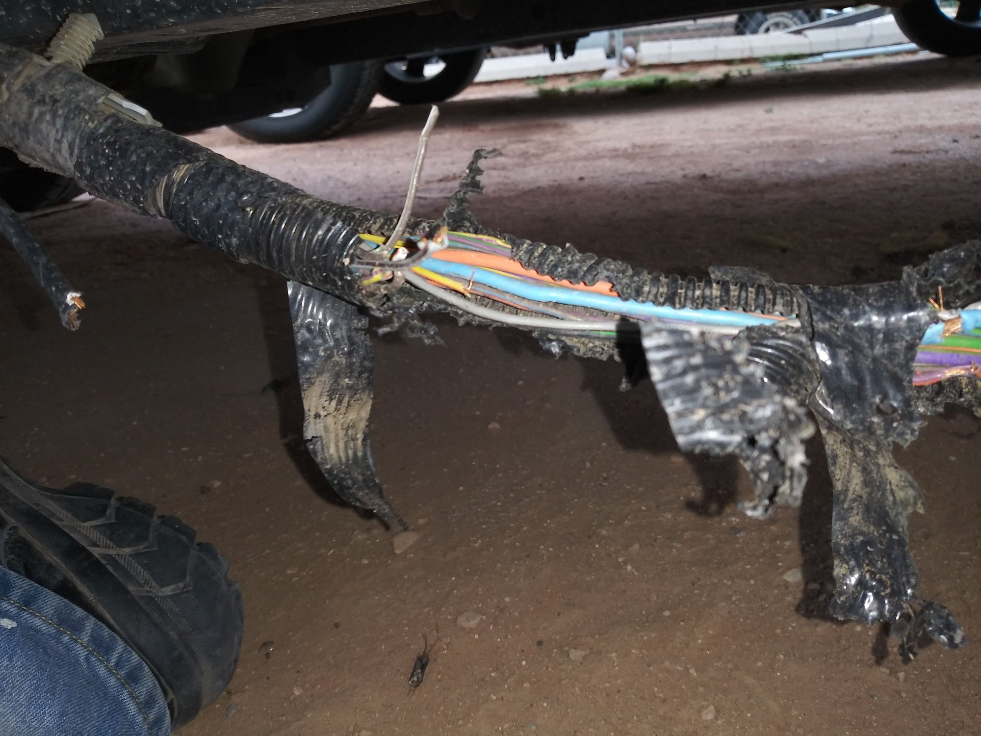

Here's a closer look at the wires.
Old May 12, 2019 | 10:42 PM
Posts: 43,539
Likes: 818
Unwrap them back a little farther till you reach areas that are not damaged, then start cutting and splicing. You can cut out and replace the damaged section of loom, then tape it up good. You can use Adel clamps and screws to fasten it back up underneath.
