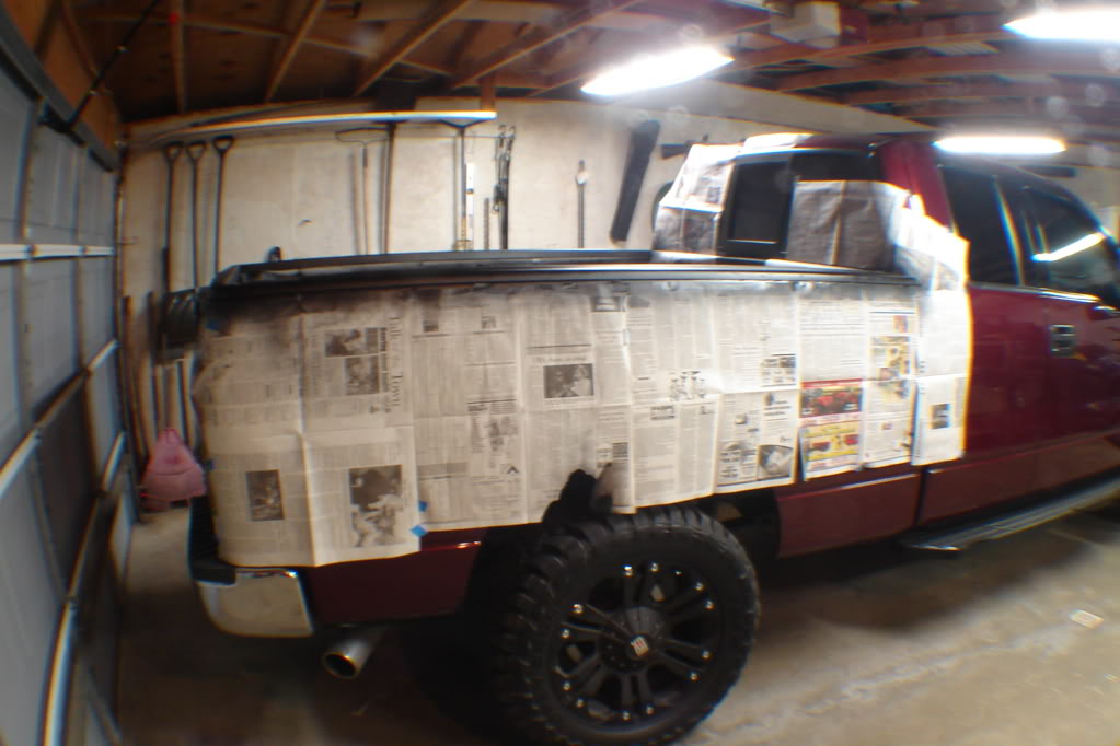

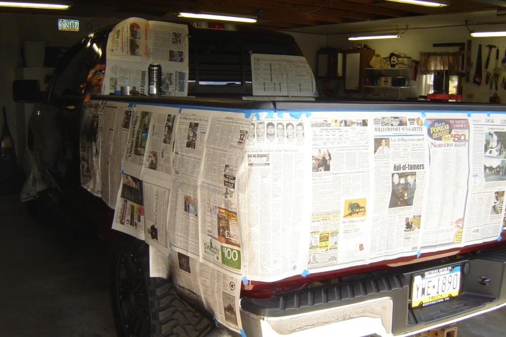

I began by spraying some Simple Green onto a cloth and scrubbing the bed rail caps real well for a thorough cleaning. I did not remove the bed caps because I've never seen it done, and I did not have any glue at hand for re-applying, and did not want to go through a huge hassle. I masked with a small margin of tape under the caps to prevent any over spray and wrapped along the entire truck bed, and tailgate.

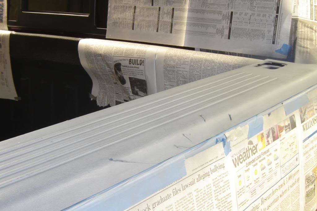

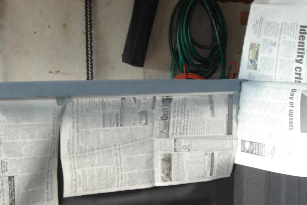

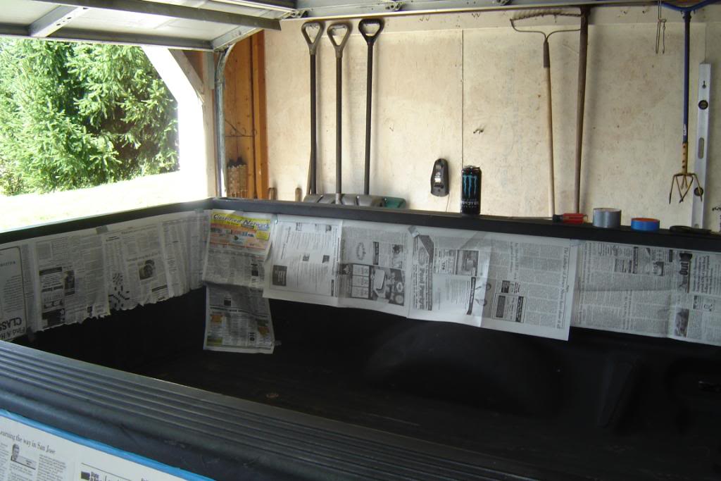

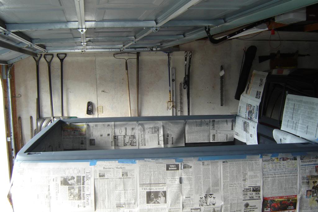

I then grabbed the s$%@ load of news paper, began unfolding and taping it to the truck bed outside, inside, on the tailgate, in the cracks of where the bed and cab meet, and the rear windows.

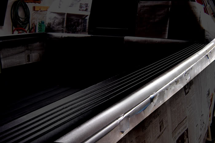

Second Step, Priming.
Because I could not find any black primer, I settled with the gray Krylon primer. I first sprayed the caps with the adhesion promoter, I did two layers with 10 minute intervals. I did two layers of primer with also 10 minute intervals, and sanded with 1000 grit between layers.

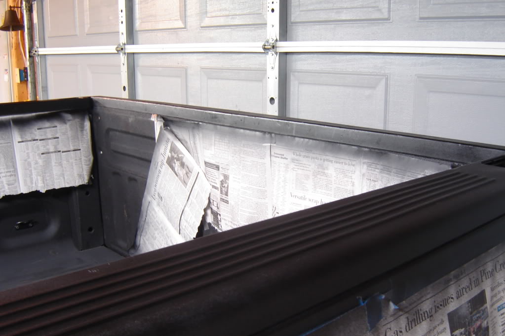

Third Step, Painting.
I used everybody's favorite, Krylon Fushion Satin Black for paint. I sprayed the caps once for with adhesion promoter to ensure a definite paint hold. Followed up with the actual paint. I did 3 light layers, 10 minutes in-between, and 1000 grit sanding between layers.
I finished here. I did not use clear coat because I did not have anything with a flat clear finish. I do not want to have glossy looking caps. So far its been 3 months since I have done this and they have held up very well. I will report if any flaking occurs. Winter is just beginning. If anyone knows of a good clear coat that is flat in finish, feel free to post.

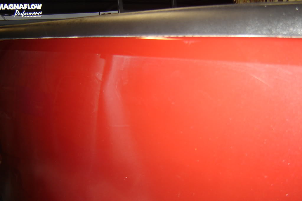

And here is a personal insurance tip. Check this out.
Notice the highlighted area. Remember way up top when I recommended two rolls of painters tape? Yes that does sound like a bit much, but I was working with a half role on my entire job. Incidentally, I should have taped over the top layer of the news paper, but since I ran out of tape and do not have another vehicle to run to the hardware store with, I made do. Well I made a mistake and had some over spray..

So be warned, a second roll of tape wouldn't hurt to buy if you aren't starting off with a brand new roll to begin with. It took me a little over 3 hours to remove all of this. I only had a smooth surface clay kit, and Meguiars Ultimate Rubbing Compound which is what really got this off. I was fortunate to catch this in time before it dried and bonded too long, and very very fortunate to have just done a full detail and fresh wax. Though I had to re-polish, and re-wax my bed after wards. What a labor involved job this was

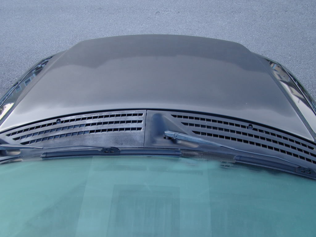

Looks good! Well done. I did pretty much the same thing (a bit less on the prep side) to my wiper cowl. As an experiment I only clear coated one side of the cowl. After 2 years or so, the side without clear looks like crap. Alot of the paint has come off, but the clear coated side still looks pretty darn good!
