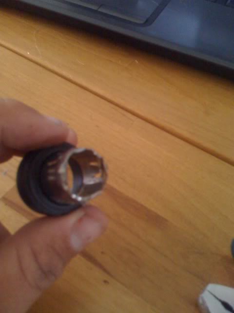

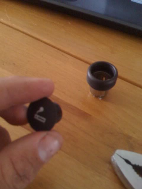

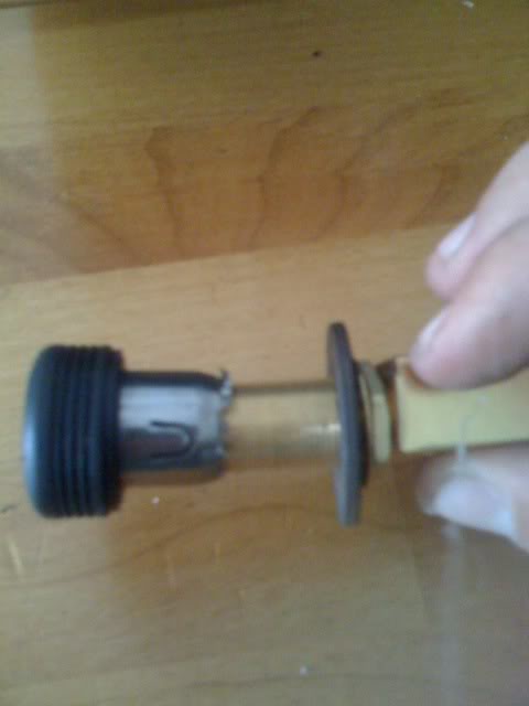

Strip the guts out

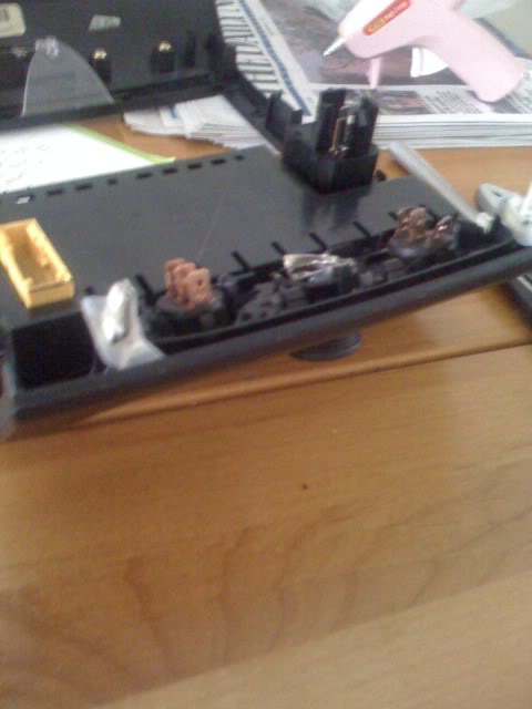

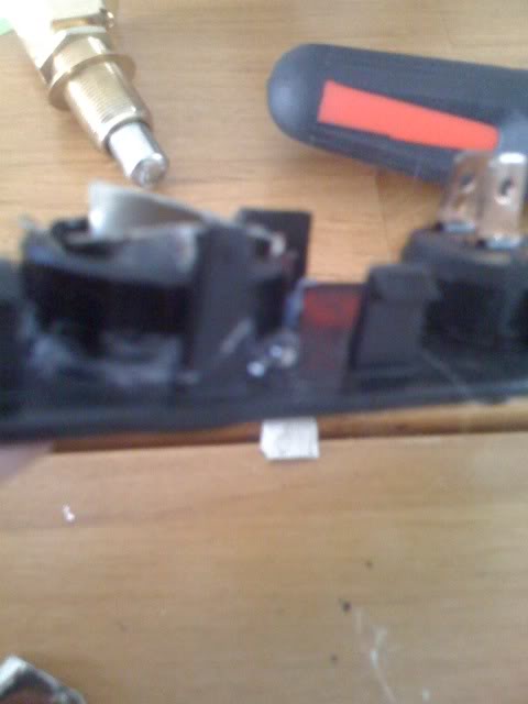

Take everything of the actual button

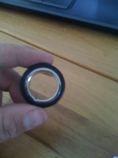

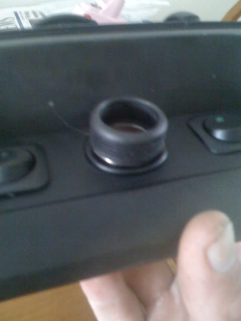

Install the socket ring back into the panel, I used a hot glue gun to make sure nothings comes apart. You dont have to I didn't the first time but i think it works better.

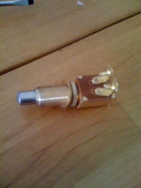

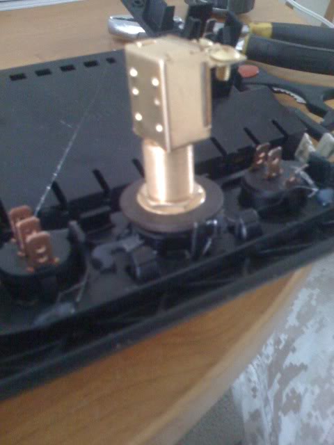

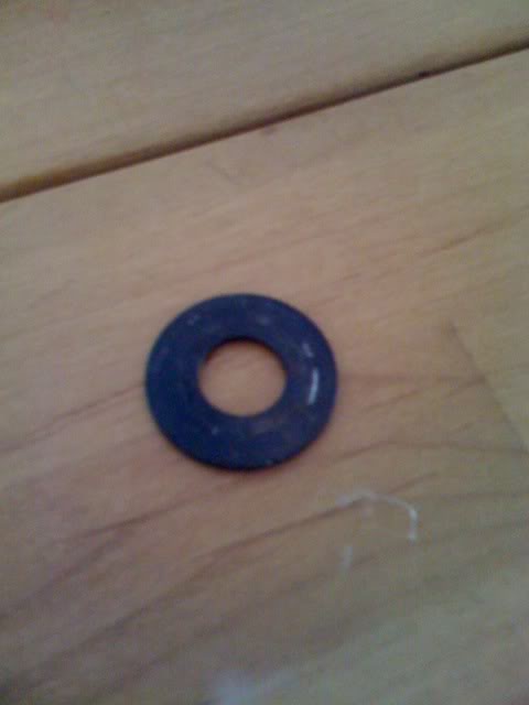

Size:  24.3 KBHeres the switch and washer setup i used. the washer is 1.5 round with a 5/8 hole

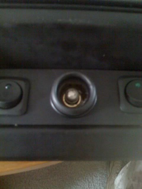

Stick the lighter housing back in

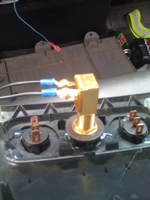

Screw the switch into the housing. And run the washer and nut up against it after you get it set this acts as a jam nut and keeps it all together.

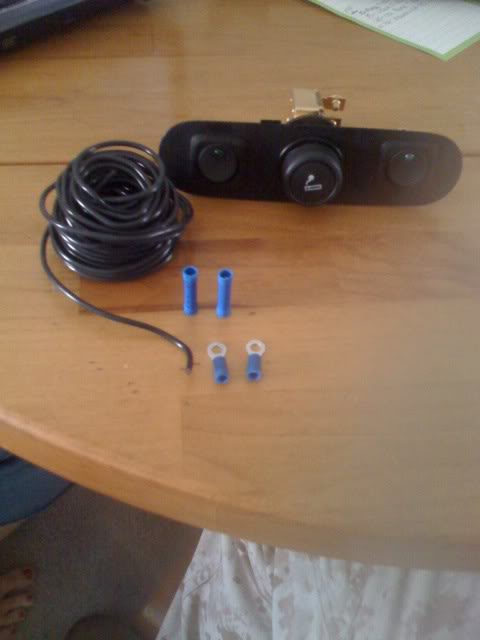

Your done with that gather up some wire and go to your pick-up truck

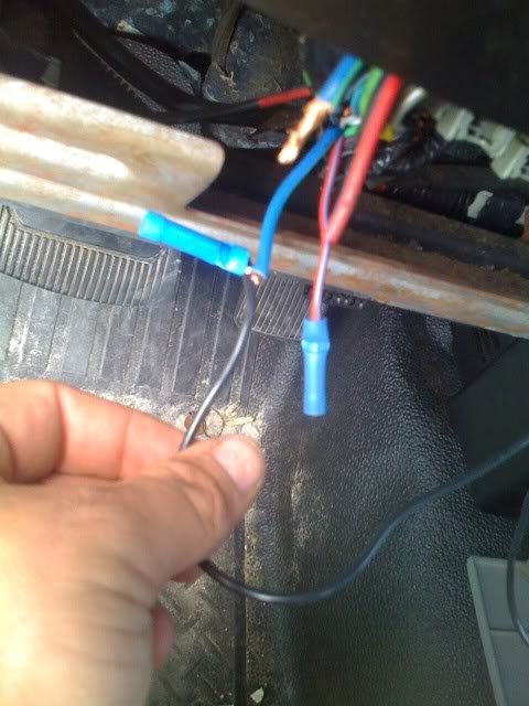

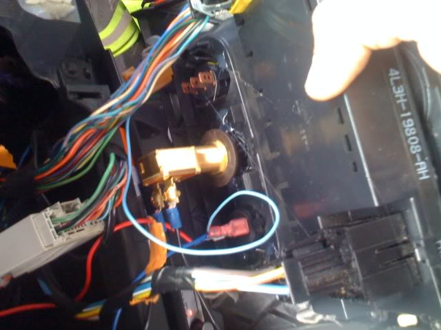

Behind the cover find two wires. BLUE/GREEN STRIPE RED/BLUE STRIPE the blue /green will be just a little thicker *this is a 2005 f150* yours may be different but i bet not. cut the two in half
Run the wire
splice into the blue/green i cut mine because butt con. were all I had. Then wire into the red/blue wire going away from the steering wheel, the one on the bottom.
Here is were you could do the Squirt mod if you want it to run with the key or button you could either splice into both wires. That will allow you to start it with the key or button when ever you wanted. or if you wanted to have a "valet" mode you can wire a switch in between the red/blue wire on a std. on off switch with two post wire the red/blue coming from the key to one side, on the other side wire the red/green and the wire going to your push button
Next wire the push button up it doesn't matter what post you hook up on just one on each.
Plug all the wires back up on the bezel
