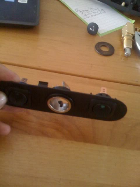

I would like to thank Porky81 for his how to on v6f150 its what gave me the idea.
http://www.v6f150.com/forums/showthread.php?t=17067
HERES HOW ITS DONE.

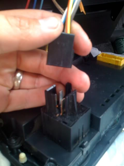

Remove the dash bezel

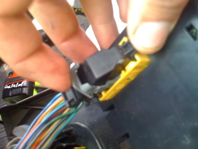

Unhook this booger it gets me every time
This should be close to how yours look.

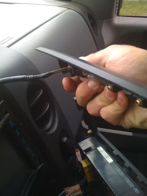

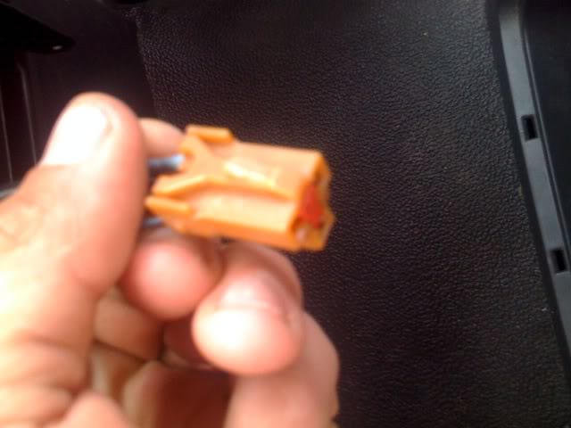

Flip this up, watch for the little catch
Get this one to.

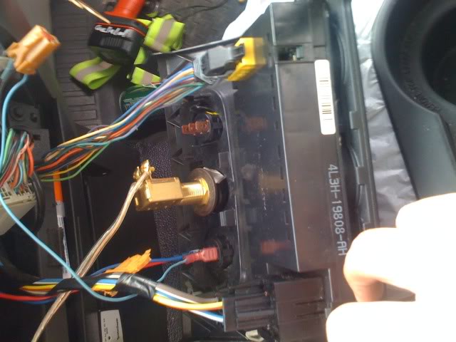

Last one undo the 12v socket

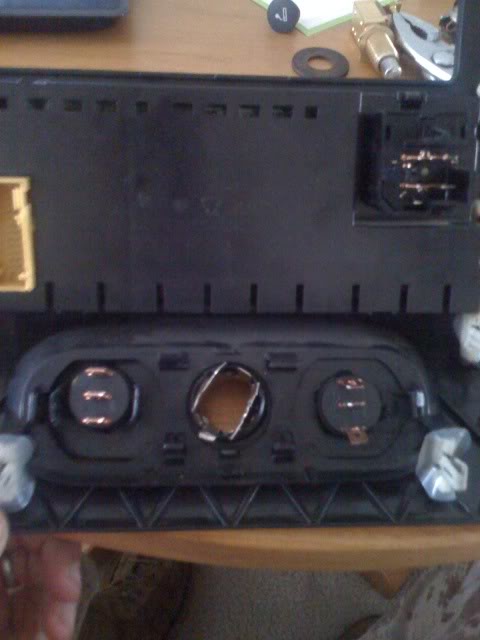

This should be close to what you have. No try to make the next few pieces look like mine, you will probably destroy the excess like i did.
Now pop the panel out
Pull the socket out, its a pain but it will pop out

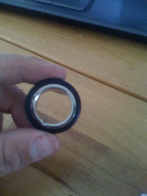

Make it look like this, you can most likley make it look better but i did mine with pliers and tin snips\

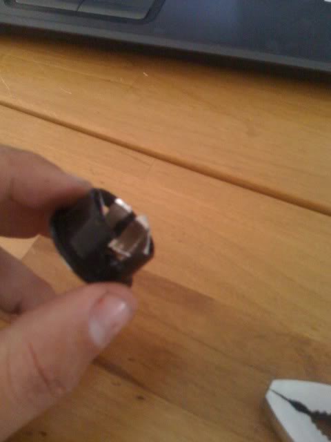

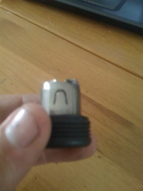

Tear the lighter its self apart now, if you cut it so that the bevel still tapers in it will act like the nut and hold the switch
