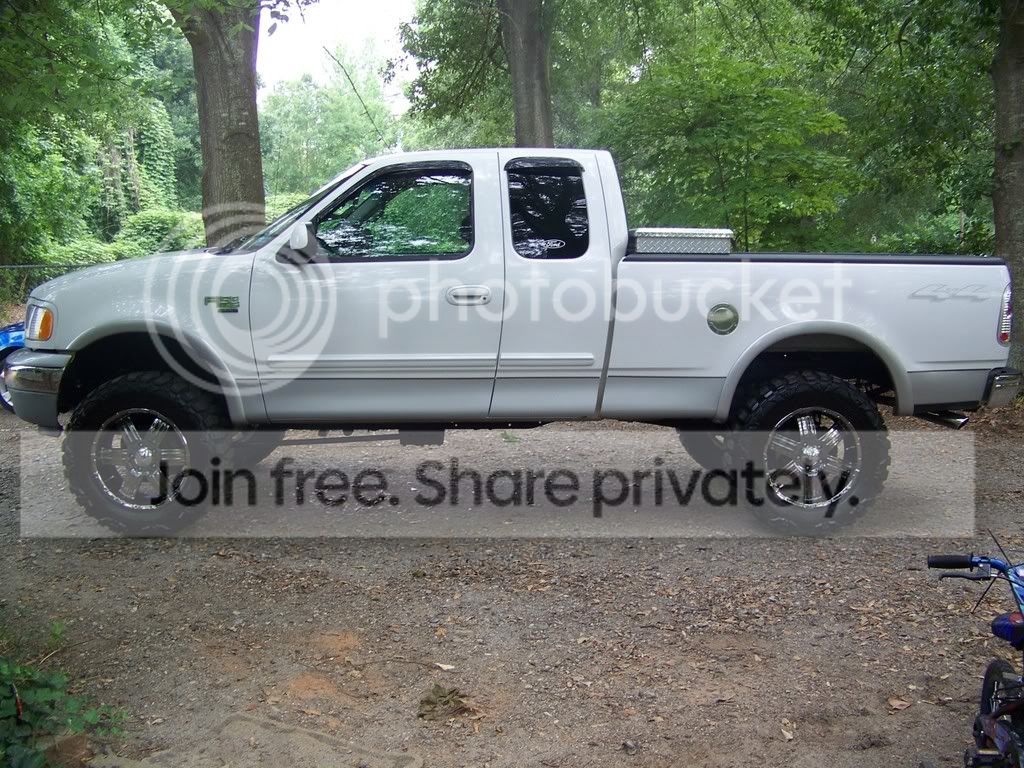

blah, lets see them on the truck & lit up

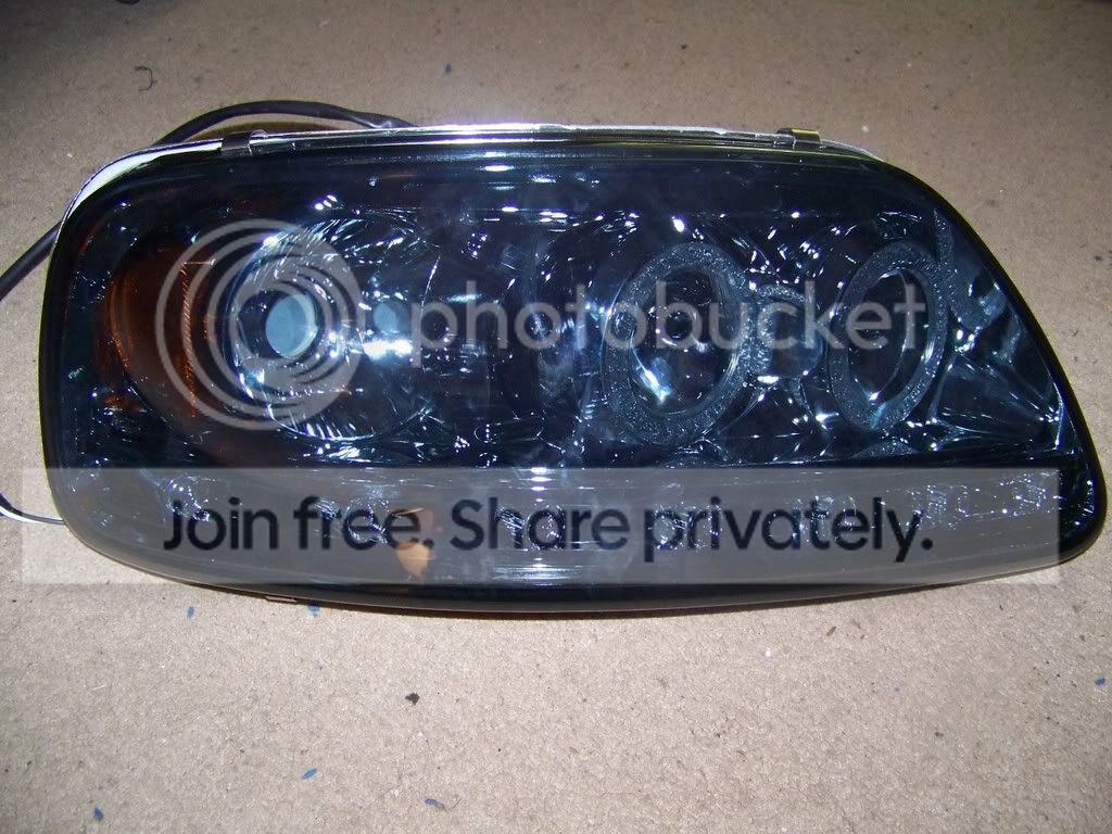

from what i can tell by looking at them, the blue plug will plug into your existing light plug, operating both hi and low beams. the rea wire looks like a ground, all the white and black wires operate the LEDs and halos. get a chilton or haynes book and look at the wiring diagram to see which wires in your stock harness go to what. then decide if your going to use the halos for parking lights or blinkers. I personally have both Halos and LEDs come on with the parking lights.
if youre not electrical savy, i would take them to a shop, or have your dad or a buddy who knows electrical to help you. there is alot stuff involved.
