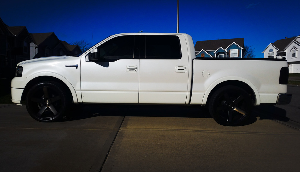

Or you could take in what PatMan had to say. I learned alot from him when I lowered my 4x4 Lincoln Mark LT. PatMan is definitely the guy to ask when in doubt !
Bell-Tech struts in front , 3" Shackle and removed block for 3/5 drop with 305-45-22
