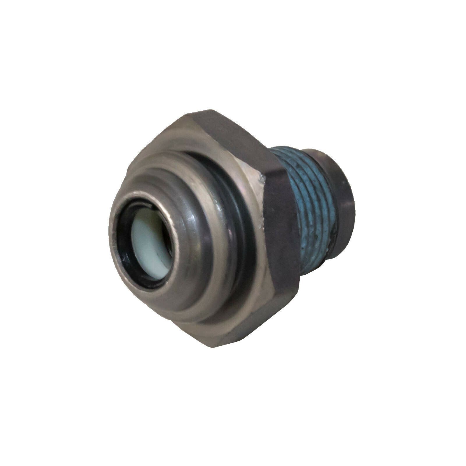

The lower quick connect fitting on the radiator is leaking profusely! I attempted to get it out, with the correct tool, and it would not budge... seems there is a replacement fitting for this... but I am at a lose as to how to proceed. I am not sure if this is a ford radioator or some other after market one, and I doubt the fitting are the same. I think what I will do is try again to get the line out, then if I can remove the fitting.... looks something like this.... but crazy expensive... almost half way to a new radiator.... Any experience with this? Thx!

No, I haven't had any experience with that type of fitting. Spray some penetrating oil on it and let it sit for a while is the only thing I can think of that might help.

Yes thats a good idea, Ill do it. I am sorta licking my wounds today. Just catching up etc... still gotta clean up my shop and put my tools away again.... Not really any room in there now after I got it all back together, but maybe just moving that fan shroud back will make it easier to access.

I got the offending fitting out of the radiator yesterday. 27 mm socket and very little room to work... trans fluid leaking and making it all very slippery... but I got it... Now I just gotta find one to put back! Once I get this fixed I can diagnose the trans a little better I hope.

Just got back from hunting for that fitting for the trans line to the radiator. Lost of them out there, but none that were what I needed. Found them on line. $35 to $65 bucks. Forget that... I ordered a new radiator... it will be better in the long run I think. I could try and order the part, be cheaper, but if its wrong... more time lost etc... Radiator will be here Tuesday or so.
