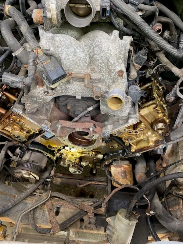

Just got this truck, found this right off the bat!

Don't think you're gonna get that cover to work easily. Moving the pump up means longer hoses, and possibly other fitment issues
Good luck with this project, gonna be a bunch of labor, but hopefully worth it in the long run
Thanks for the reply! I whole heartedly agree.... I was able to find the correct one late on friday. Got pics, so I know it will fit, and it is on the way. It has been so confusing to find this exact cover. I think, and no real conformation, that this truck has to have this exact part for this year and this truck.
So I got a good part for some other ford product if anyone needs it! LOL
And it has already been a lot of work, but I think once I get the parts it will go quickly on reinstall. It is a truck with good potential. Not afraid of hard work.
Thanks

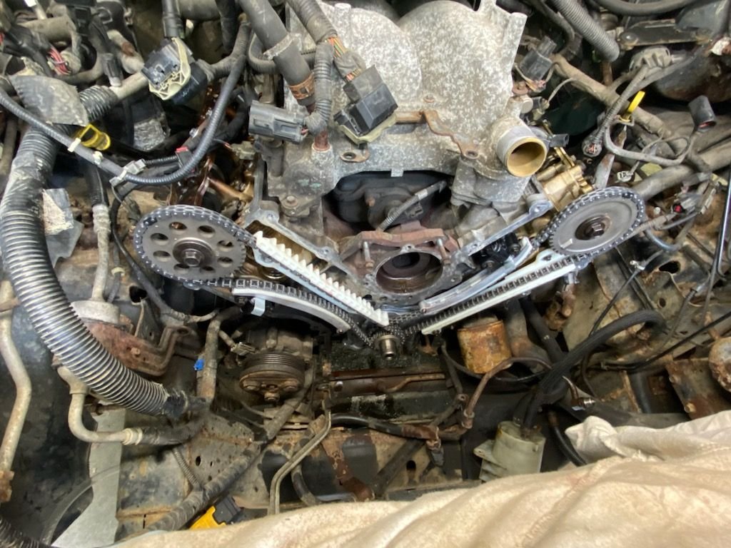

Trying again. Would not even let me post one picture. So yesterday getting started noticed that the cams did not index the chains. I loosened the cam holder clamps and gave another crank on the crank, (one full turn) and I could mark them and make sure things were good.
You can really see the right side is very slack. The tensioner was almost worn through the guide on that side. Glad I did this.
took off the old components and the oil pump and then reinstalled the new parts.
Couple of things of note and I did not take pictures: first the bolts that hold the oil sump screen tube to the pump were too long for the new pump. WTF??? Rather than just keep tightening and crack the pump, I ground the bolts down just a tad and used a washer on each one and all was good. Also on the right side upper timing chain guide the bolt that came out was too short for the new guide.... So I rooted around in my stash of parts from other jobs, and found one that fit. Torqued and ready to go. I dont think it was grade 8, but it has no real stress on the bolt so I am hoping it will be good. Used lock tite on all the parts and torqued to spec so Im pretty sure its ok.
Old chains came out and the marks I made were exactly 180 degrees out from each other. Nothing moved so put it all back that way and I should be good!
Discoloration of the gears is from break clean. Hard to see my marks, I used red sharpie
Ok back to it... ready for timing cover now!
