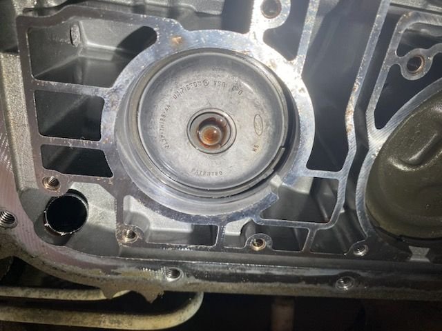

Also when I took the valve body down there were three pieces of the circlip that holds in the overdrive piston/plunger
You can see the parts that are broken off.... I do not think I found all of it... I looked and used a magnet as well.... I took out all the ***** and replaced them as well. So If I did n ot find all the parts of the circlip is that bad? I looked through out the valve body and saw no pieces... actually that is why that little screen is out because I thought it was something that did not belong.... I put the new gaskets and plate back on... should I put that screen back?

So I went over the valve body again... glad I did... found the other end of the circlip in the overdrive valve..... wedged in... when I took it out the valve snapped back closed like it was supposed to.... I kept going, but found no more parts of the circlip,
Got the old circlip out but man so far that has been the worst part of this job.... a coupe pieces broke off.... and I could not get the other ends to pop out to grab, so I drilled a small hole in one end of the clip, stuck my small pick in it, wedged it out put a screw driver behind it and popped it out! The bore was fine... I could have gone with the old plunger put I put a new one in. I was able to get the overdrive band stabbed by the plunger Im pretty sure.... Im not really sure how to ck but I think I got it....
You can see cracks in the old ring
new plunger and circlip installed.
Almost done...
