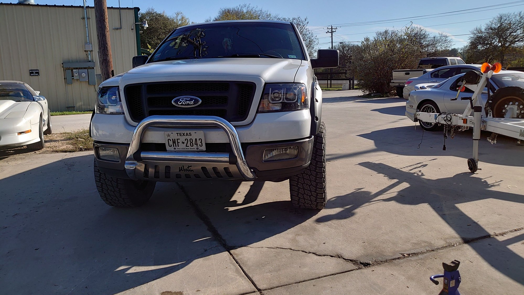

By accident and carelessness i purchased some 305/55 Nitto Terra Grapplers to put on a set of 20x10 Fuel Vortex rims with a -15mm offset. I also have the RC 2" leveling kit on the front of my '05 FX4.
I have a bit of rubbing on the front of the wheel with not much of a turn at all.
I cut the a pie shaped piece of the lower front bumper trim off to fix that problem.
The bigger issue is the constant rubbing that can be heard when I go into reverse to back into a parking space or otherwise turning the wheel almost full tilt while backing up. I can go just about full tilt before it rubs and I can see where it is rubbing. I was thinking about doing a combo of a 4" lift (I dont want a lift but now i need one and I cant go too high or i wont be able to park where i normally do) and also getting some custom body work done in the area where the tire is rubbing on the back of the front wheel well.
I have two questions.
-do yall think that a 4" lift will help with my clearance issue.
- what do you think about instead of removing the wheel well covers and the trim and hammering it back an inch or two i was wanting to have the body nearest where your Drivers left foot can point and touch with your toes and the same area but on the passenger sides right foot (forward of where the fuse box is) it looks to me like theres at least two inches of space that I can cut out. i guess you can say that in effect it would be lessening the amount of leg(foot) room. I have a friend that offered to do that custom work for only $300. I like that option better than having to lift my truck because I never wanted it lifted in the first place. I have a few pictures. I took a tape measure to it while I was TRYING to install the RC fender flares with the stock hardware. ended up saying screw it to those metal clips and used self tapping screws to hold them in place.
i didnt measure this but its definitely not the stock 4" any longer. my educated guess says that its 6" now. lol
wider stance but not toooo wide. Just how I envisioned it looking. So happy!
In this photo, and all of them actually, i had not yet cut the pie shaped triangular piece off of the lower front bumper trim. I cut the piece off of the section that is cornered and closest to the 3 o'clock position on the tire. when i turned going backwards this would catch. Cut it off with a sawsall and problem solved. as you can tell my front lower bumper is damaged from a colision. I will be replacing this with an Pre runner type singular front bumper instead of this stock three piece
dont make fun of my smirk. Its going to the shop for a whole new front bumper, grill and hood soon enough. It probably cost more to fix the stupid Mercedes that stopped in the middle of the road for a vehicle in another lane.
Once i manhandled the stock fender flares off (which by the way were much harder to get off than what the RC instructional video showed but only because for whatever reason my FX4 has a different type of connectors. I threw them all away as they were of no use to the installation of the new RC fender flares.
Left Rear New Wheel & Tire.I got the look i was going for with the offset of -15 on the FUEL Vortex 20x10 wheels and Nitto Terra Grappler G2 305x55 tires. Yay I was going for stability with a widened stance. I feel safer and can definitely feel the road more. I like the way it turned out but watch out for puddles!!! nobody mentioned how dangerous these wider tires could be in wet conditions. I was taken off guard and will for ever be much more cautious when driving in the rain for now on
Left Rear Wheel with new flares and tires
Front drivers side before i put the 2" RC leveling kit,
Rear of the front drivers side wheel well with straightened steering wheel. The area beneath the 4" mark on the inside of the wheel well cover can be seen as having been discolored from only a few turns from the tire shop to my house. nothing crazy, normal driving (except i started making very wide turns when ever possible ) This was the morning after install. A fw wx later i have seen rub marks in the area around but slightly lower than there the 3" mark is on the tape.
Rear of Drivers side frnt Whl Well with the steering wheel 90-95% full tilt PICTURE 1. as you can see, the clearance is no longer there.
Rear of Drivers side frnt Whl Well with the steering wheel 90-95% full tilt PICTURE 2 heres the lower corner where i am getting the constant rubbing from the wheel well and trim and fender flare bolts that are securing everything into place inside the wheel well. I want to cut a good portion of this out to make more room in this general area nearest this picture and Pic 1s area.. like foot or so in towards the pax side and do the reverse on pax side as well.
rear of the drivers side front wheel well with the wheel full tilt to the right.
This is the area that I am wanting to cut out and push back towards the rear some. My 33.4x12.4 tires s are rubbing up against the area behind the 2.75" tape mark. its the exact and surrounding few square inches that rubbing can be seen where the wheel well cover, lower trim and fender flares are all secured by two bolts of sorts. I think that i have a good 2" of extra clearance sitting there waiting for me to cut into it. I'm thinking like a 12"x 14" area pushed back a full 2". im just guessing numbers here and know that I wold need to look out for the pedal system and such but what do you guys think?
I have read stories about people saying to unscrew and then zip-tie the wheel well cover to a position further towards the rear. I dont see that being a solution to my problem since i have a -15mm offset leaving me with the option to either get smaller tires, (not going to happen these weren't cheap) cut into the firewall i guess is what it's called and make more room for suspension and wheel travel or lastly go with the option to just get a 4" lift and be done with things.
Rough Country has a 4" suspension lift that they say will clear a 35x12.5 -12 since I have the -15 offset am i screwed?
