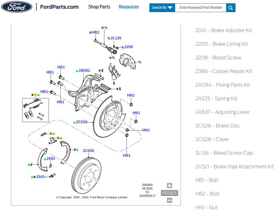

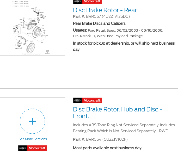

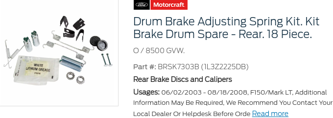

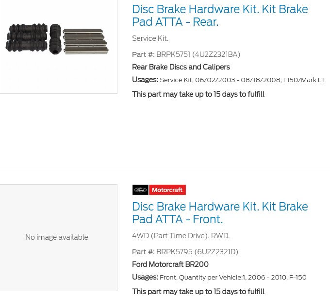

I usually start with parts.ford.com to see what the OEM part numbers are and to take a second look at the parts diagram. See if there are other parts you might need, like a kit for the parking brakes or brake pad hardware, bleeder screws, etc. Then check some of the brake companies for part numbers, and check for pricing and availability. There's OEM, which is obviously MotorCraft. Then there are many grades of aftermarket parts. Some not as good as OEM. Some better. And be ready for the sticker shock and price differences. Now you have to decide if it's cheaper to buy different parts, or buy a kit. Some brands may have better marketing, and higher prices, but does that mean that their brakes are better? If you spend more, will the brakes last longer or stop better?
