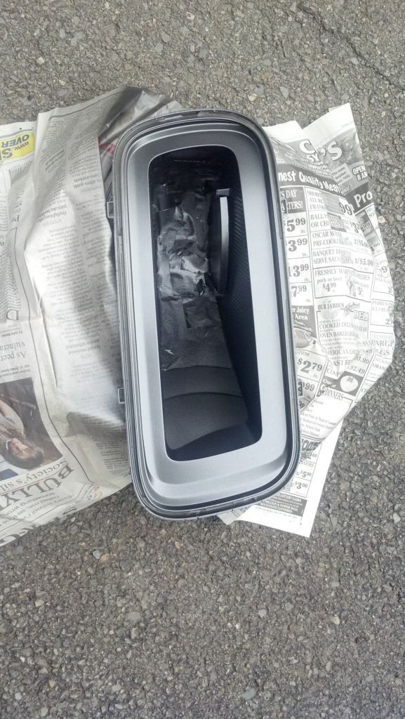

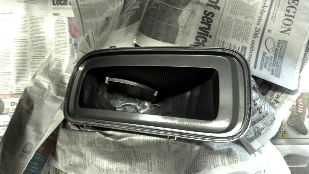

My friend gave me the opportunity to give his truck the painted fog mod for his 2004 FX4, silver birch n DSG two tone. Instead of painting them black like usual, I PTM'd them with the two tone. It turned out perfect! Almost made me want that style bumper back. I used Dupli-Color Perfect Match DSG paint and their high gloss clear coat. Along with using 1000 and 2000 grit sand paper to scuff the chrome housings up.
Here are some pics from my Droid Bionic.
The project.
In progress of masking.

Painted with 3 layers.

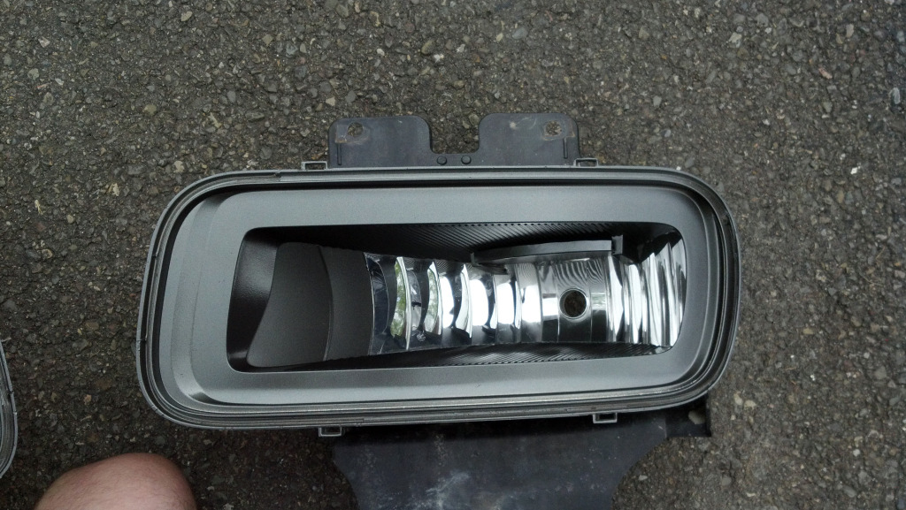

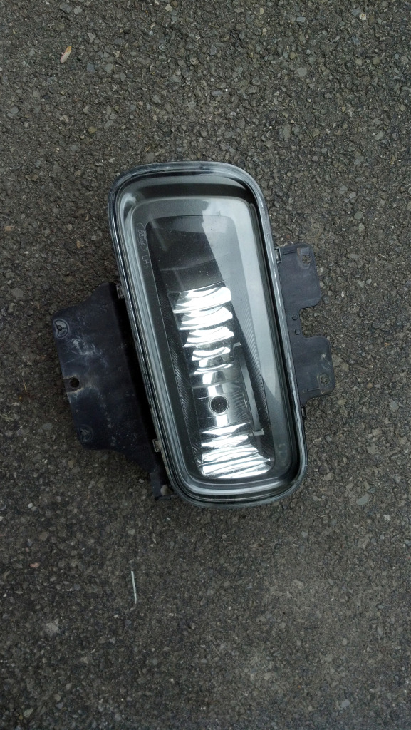

De-masked.

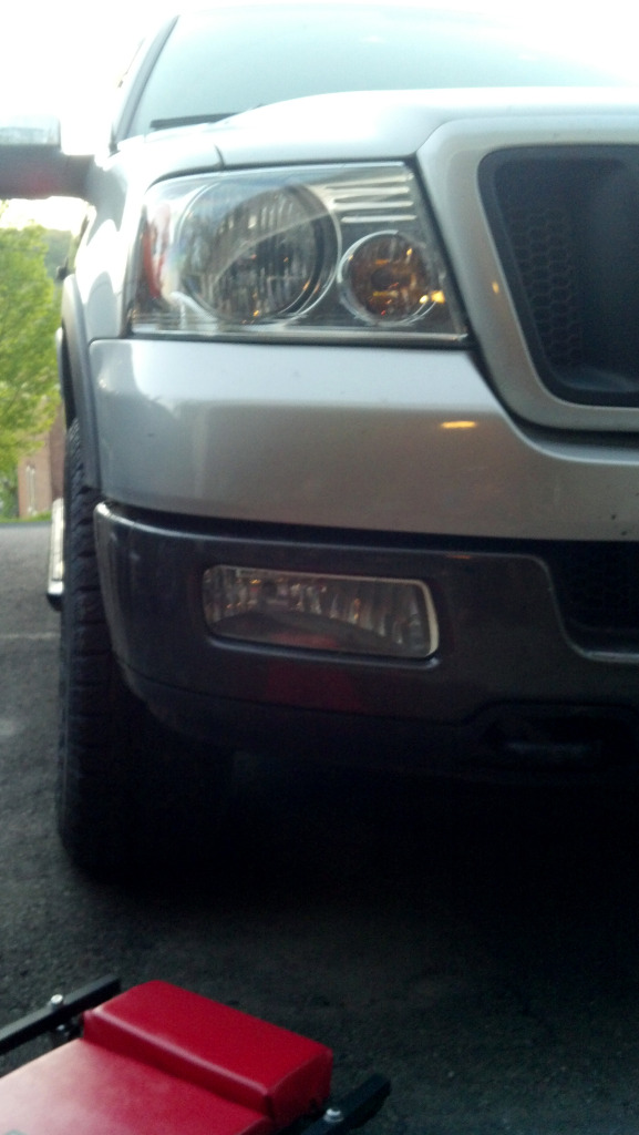

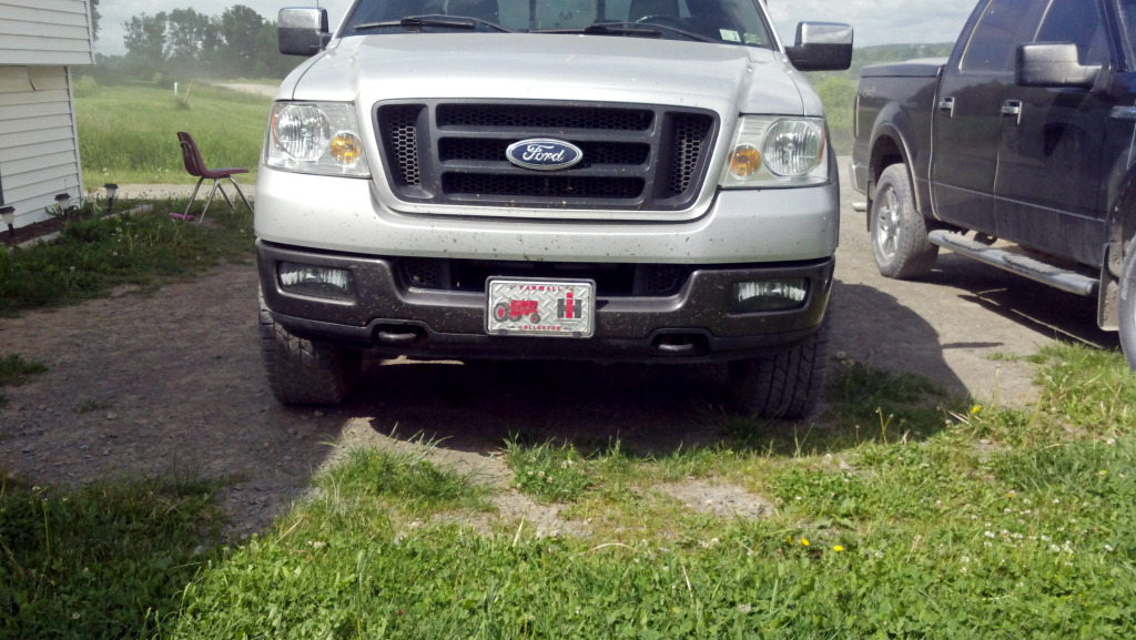

Installed!
